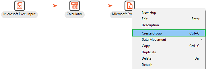

  • Hops ( )
Hops connect the steps or entries in a workflow or process, respectively. A hop is represented as an arrow. Hops determine the direction and flow of data through the steps or entries, and act as conduits for data flow. You can connect the steps or entries using the hop in following ways:
  • Select the step or entry, and hover over it. In the toolbar, select and drag it to the next step or entry.
  • Select the step or entry and press SHIFT, and then drag the mouse to draw the hop to the next step or entry.
  • Select two steps or entries using CTRL | left-click, and then open the contextual menu, . Select New Hop and join the two steps or entries.
  • Select a step or entry in the workflow that you want to connect to another step entry, and then double-click on a step or entry in the Design tab. The step or entry appears on the canvas with a hop connected to the already selected step or entry.

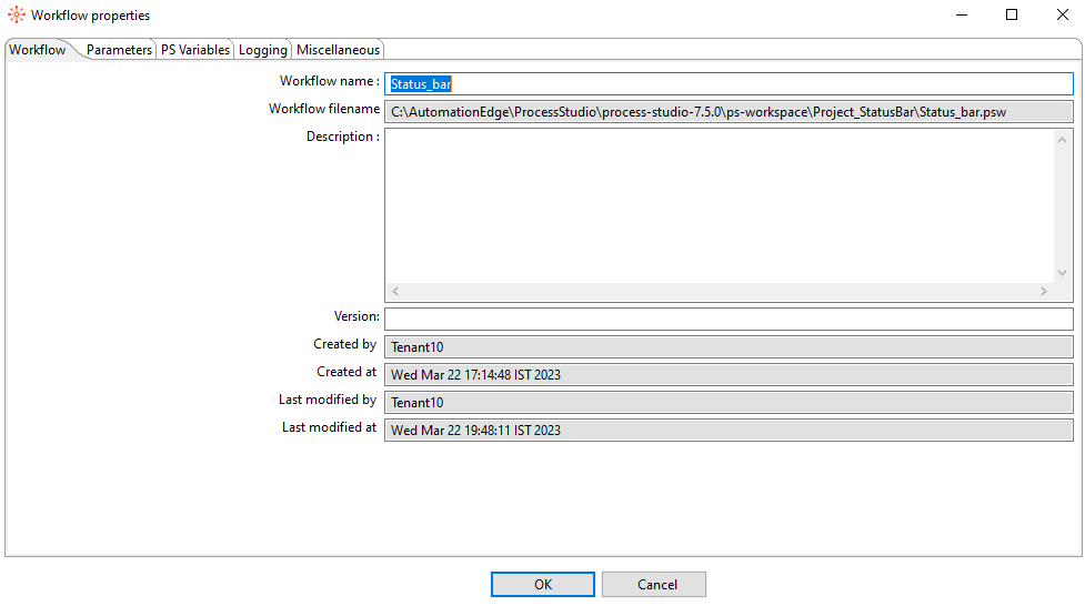

  1. Right-click on the canvas and select Properties or select CTRL | T. The Workflow properties dialog appears.
Figure 57: Workflow properties dialog
You can also open the Workflow properties dialog through Edit 🡪 Settings... or double-click anywhere in the canvas.
  1. Specify the required details in the following tabs: Workflow, Parameters, PS Variables, Logging, and Miscellaneous.
FieldDescription
Workflow
Workflow nameEnter a new name of the workflow.
-If you modify the name of an existing workflow, then the name is also updated in the Project Explorer.
Workflow filenameDisplays the path of the workflow.
DescriptionEnter a description of the workflow.
VersionEnter a version number.
Created byDisplays the name of the user who created the workflow.
Created atDisplays the date and time of workflow creation.
Last modified byDisplays the name of the user who last modified the workflow.
Last modified onDisplays the last workflow modification date and time.

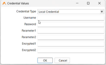

- Select Type as Credential, and then click the Default Value field, to open the Credential Values dialog.
A screenshot of a computer Description automatically generated
The Credential Type list contains the list of all AE server credentials. However, the default value is the current credential.
Important:
- For all AE server credentials to be available in the list, ensure that you sync the cred entials.
- If you select an AE server credential, then the other fields in the dialog are read-only.
- If the AE server credential is deleted from the server or the permission is revoked for the tenant, then you will see a notification.

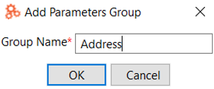

When you click , the Parameter Configuration dialog appears. It displays the list of parameters entered in the Workflow properties dialog. You can view the toolbar in the dialog.
i. Select to add a new group. In the Add Parameter Group dialog, enter the name of the group.
ii. Select the parameters to drag-and-drop to the group. You can create nested groups up to three levels.
iii. Right-click on the group name, the contextual menu appears. Select Rename or F2 or to rename the group and Delete or DEL or to delete the group.
iv. To expand or collapse the groups, select or respectively on the toolbar.

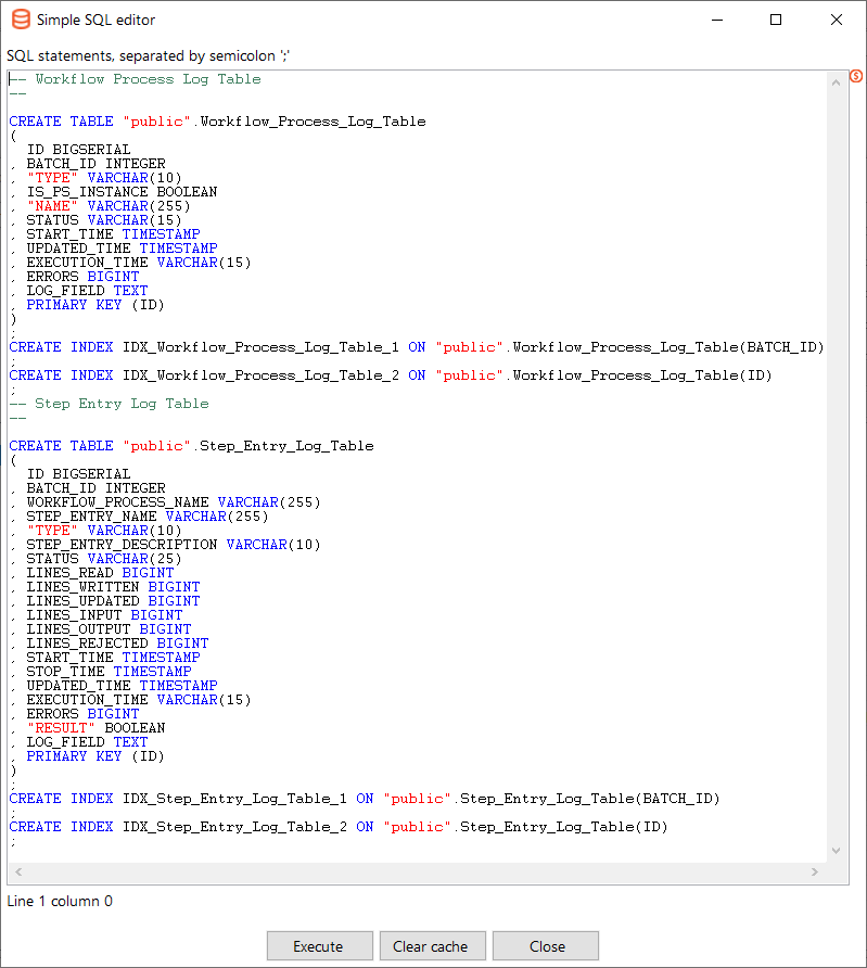

In the Logging tab, the following two options are available in the left pane: Workflow and Step. Select either Workflow or Step, and view the list of fields and their description, respectively. The fields listed for Workflow or Step are available to log step metrics data.
Click Create Table and create a new database table, such as Workflow_Process_Log_Table and Step_Entry_Log_Table.
In the result window, click Execute.
The tables are created.
Creation of the tables is a one-time activity.

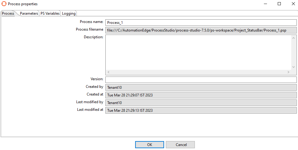

  1. Right-click on the canvas and select Properties or select CTRL | T. The Process properties dialog appears.
Figure 58: Process properties dialog
You can also open the Process properties dialog through Edit 🡪 Settings... or double-click anywhere in the canvas.
  1. Specify the required details in the following tabs: Process, Parameters, PS Variables, and Logging.
FieldDescription
Process
Process nameEnter a new name of the process.
- If you modify the name of an existing process, then the name is also updated in the Project Explorer.
Process filenameDisplays the path of the process.
DescriptionEnter a description of the process.
Created byDisplays the name of the user who created the process.
Created atDisplays the date and time of process creation.
Last modified byDisplays the name of the user who last modified the process.
Last modified atDisplays the last process modification date and time.
For details about the Parameters, PS Variables, and Logging tabs, see Create a workflow.

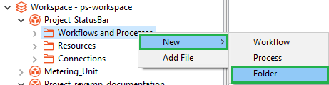

To create a folder:
  1. Under project, select Workflow and Processes and right-click. The contextual menu appears.
  1. Select Folder, the Create Folder dialog appears.
  2. Enter the name of the folder and click Create. The folder is created under the selected project.
  • Select the new folder and right-click on it. The contextual menu appears. If there is an existing folder the Delete option is also available in the contextual menu.
  • You can also select Resources, and then select New Folder to create a new folder.

To create a group:
  1. In the workflow, select the steps that you want to group and right click on them. The contextual menu appears.
Figure 59: Contextual menu 🡪 Create Group
  1. Select Create Group. The Group dialog appears.
Figure 60: Group dialog
  1. Enter a name for the group, and then click OK. The selected steps are grouped together and a new group icon replaces them on the canvas.
Figure 61: Group view
The group appears in the View pane as follows:

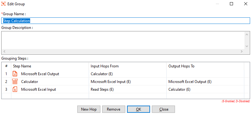

To edit a group:
  1. On the canvas, double-click the group icon. The Edit Group dialog appears.
Figure 62: Edit Group dialog
  1. Modify the field details.
FieldDescription
Group Name*Modify the name of the group.
Group DescriptionModify the description of the group.
Grouping StepsProvides a list of steps grouped together.
Right-click on each step and check the menu options available.
* indicates a mandatory field.
  1. In the dialog, click New Hop to reset the existing hops.
  2. To remove a step from the group, select a step and click Remove. The step is removed from the group but is not deleted from the workflow.
Figure 63: Group dialog
