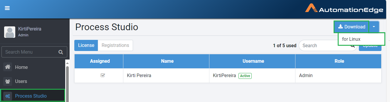

- Sign in to the AE UI as the Admin and go to Process Studio. The Process Studio page appears.
Figure 1: AutomationEdge user interface: Process Studio page
- In Process Studio Registration page, click Download. The Process Studio zip is downloaded for Windows.
- To download Process Studio for Linux, click the corresponding dropdown.

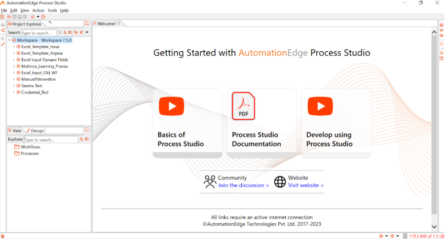

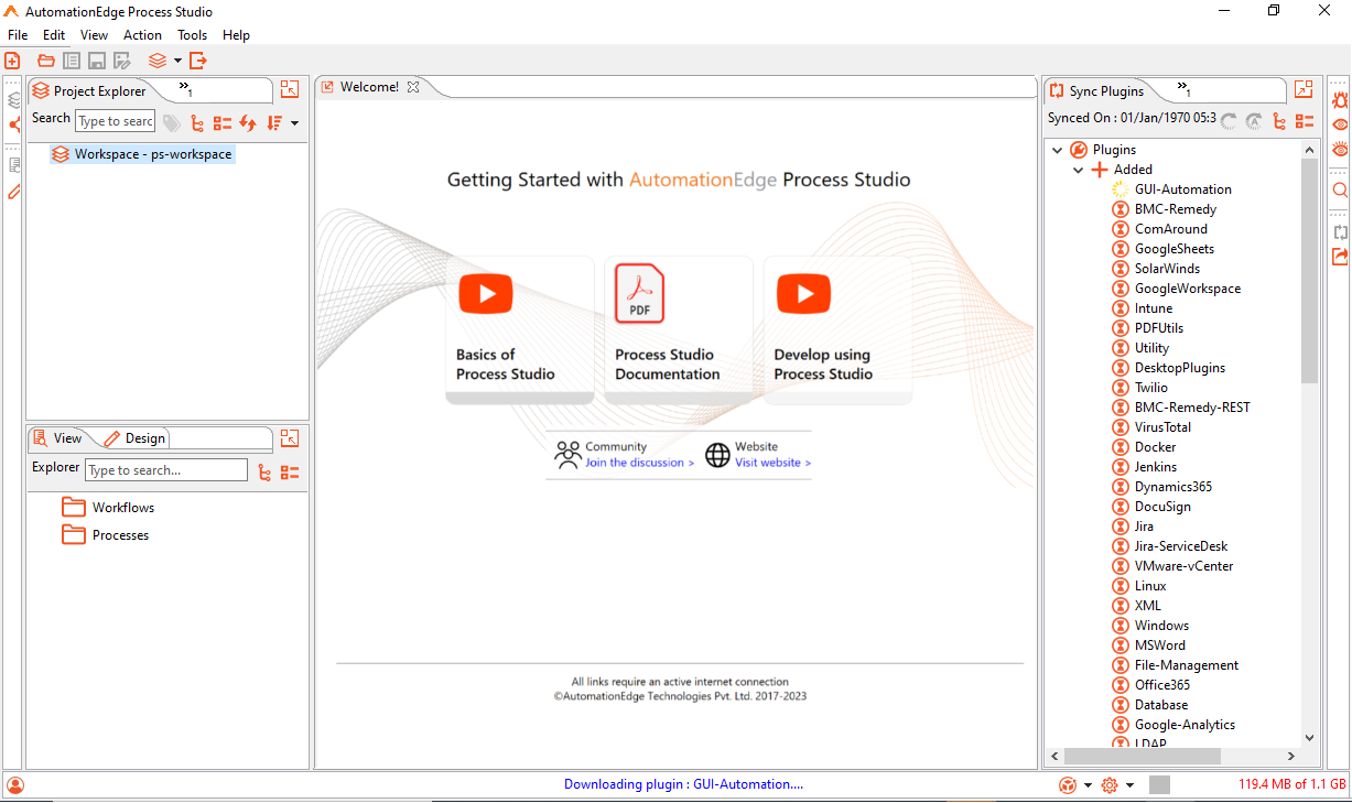

- Click Launch. The Process Studio opens.
Figure 4: Process Studio
After the Process Studio opens, you will see the list of plugins in the Sync Plugins pane. For details on synchronization of plugins, see Synchronize Process Studio with AE.

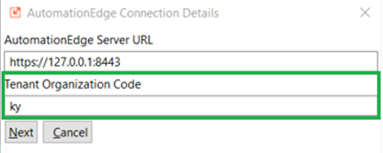

In the dialog, click Sign In with SSO. The SSO sign in details dialog appears.
Enter your tenant code in Tenant Organization Code and click Next. The AutomationEdge server connection is initiated.
Figure 5: AutomationEdge Connection Details dialog

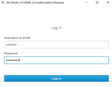

- After the connection to AutomationEdge server is complete, the IDP Log In page appears.
Figure 6: AE SSO log in page
Enter your AE SSO details, such as username or email and password in the Username or email and Password fields, respectively.
Click Log In, the Open Workspace dialog appears. Browse for your workspace and click Launch. Process Studio opens.

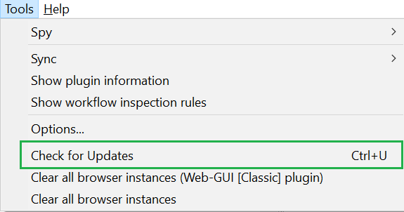

- You can also check for updates, manually, through the Tools menu in Process Studio.
i. In Process Studio, click Tools and select Check for Updates.
Figure 7: Process Studio 🡪 Tools 🡪 Check for Updates
ii. If Process Studio is already up-to-date, a No updates available, message appears. Click OK to close the message. And if updates are available then, Process Studio is updated and restarted.

When you sign in to the Process Studio, new or updated plugins from the AutomationEdge server are automatically synchronized. You can see the plugins in the Sync Plugins pane. You can also manually synchronize the plugins through Process Studio, Tools 🡪 Sync 🡪 Plugins.
Known issue: Plugins are not syncing in the Process Studio due to time difference between the Process Studio and AE server.
Synchronization also cleans up any invalid plugins in Process Studio.

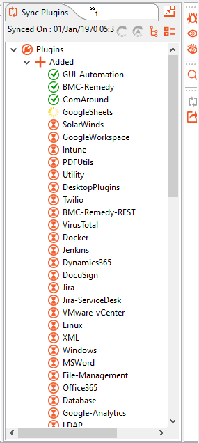

Synchronize plugins automatically
When you sign in to the Process Studio, it automatically checks for any plugin updates and synchronizes the plugins.
You can view the new, updated, or deleted plugins in the Sync Plugins pane. In addition, you can also view the list of updated or deleted files.
Figure 8: Process Studio 🡪 Sync Plugins view
: Indicates plugin sync is successful.
: Indicates the plugin sync is in-progress.
: Indicates plugin sync awaited.
You can continue working with the Process Studio even when the syncing of new plugins is in-progress. The Process Studio does not restart if plugins are added. However, if a plugin is updated or deleted you are requested to restart the Process Studio.
- Existing workflows or processes in the Process Studio display a message informing about missing plugins. After the sync is complete the workflow or process will work as expected.
- When plugin sync is in-progress you cannot perform server activities, such as publishing workflows, checking for updates, switching workspace, or again syncing the Process Studio.

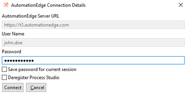

Figure 10: AE Connection Details dialog
Run Process Studio, and in the AutomationEdge Connection Details dialog select Deregister Process Studio.
If the deregistration is successful a message confirming the success appears.

- In Process Studio, select
on the toolbar. AutomationEdge Connection Details dialog appears.
Enter the password and click Connect. The process is initiated, and a message confirming the deregistration appears.
