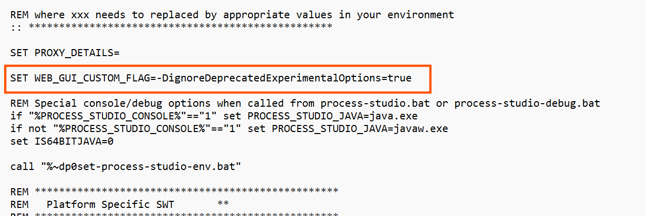

To Update Process Studio
  1. Open the process-studio.bat file.
  2. Add the WEB_GUI_CUSTOM_FLAG variable to the script. See the following screenshot:
Process Studio process-studio.bat showing WEB_GUI_CUSTOM_FLAG configuration

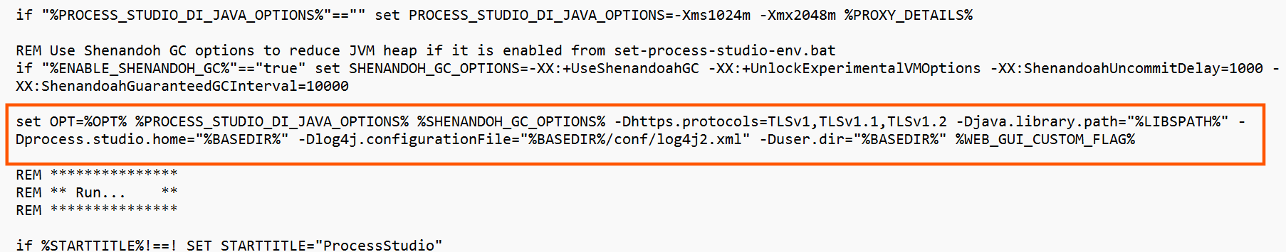

  1. Update the following in the file:
Updated flag configuration in process-studio.bat

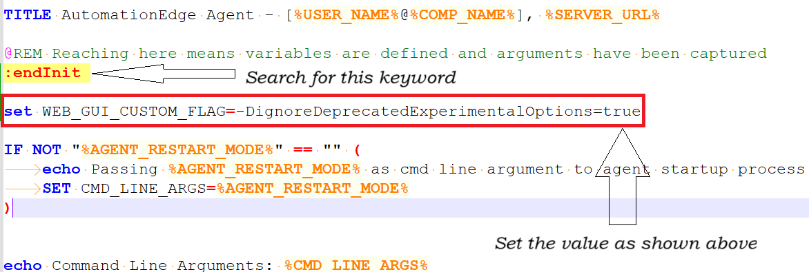

Step 1:
For AE-Agent, update the flag in startup.bat file as follows:
  • Open the startup.bat file.
  • Search for the :endInit
  • Set the custom flag by adding the following line
    set WEB_GUI_CUSTOM_FLAG=-DignoreDeprecatedExperimentalOptions=true
AE-Agent startup.bat showing WEB_GUI_CUSTOM_FLAG configuration

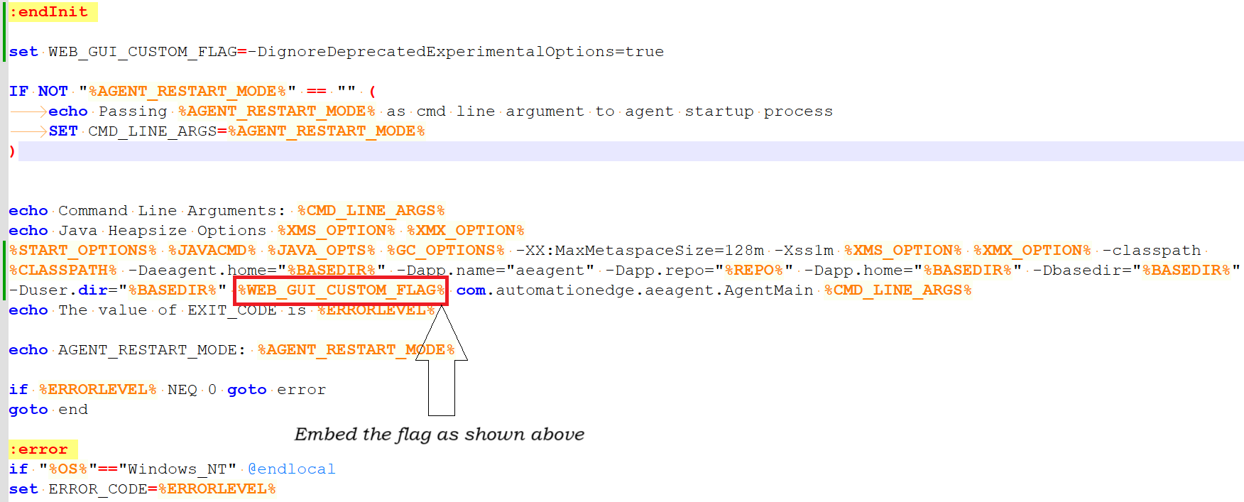

Step 2:
Embed the flag into the configuration sequence. See following image:
Embedding WEB_GUI_CUSTOM_FLAG in startup.bat

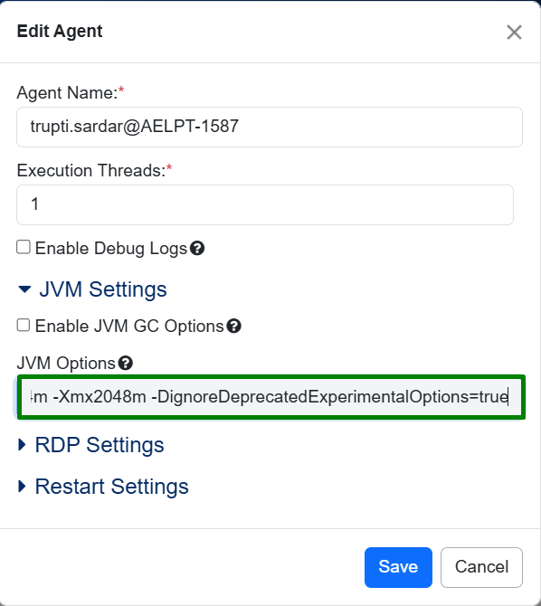

As a Tenant Admin, you can also set the flag, -DignoreDeprecatedExperimentalOptions=true directly through the Agent Settings option in the AE UI. For details, see section To view the agent details -> Edit agent field details in the AutomationEdge User's Guide.
Agent Settings option in AE UI for setting the flag

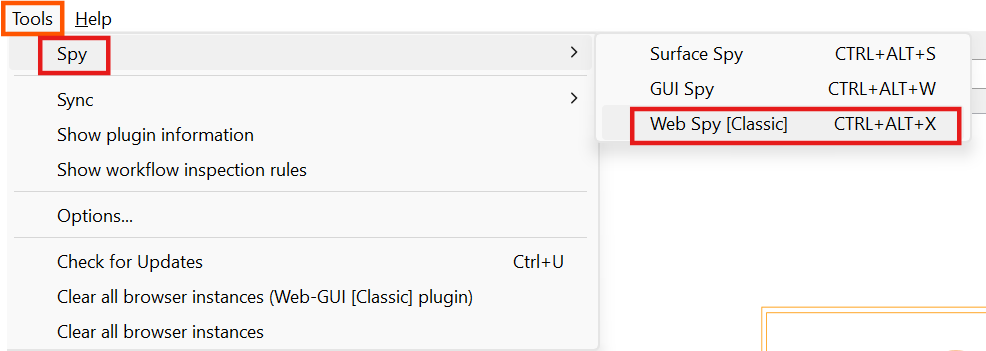

Web Spy [Classic]
Use Web Spy [Classic] to open a web application on selected web browser. Using Web spy [classic] toolbar, you can build a workflow with Web-GUI [Classic] plugin steps for web applications. For more information on tool icons, see section Appendix: Web Spy [Classic] > Web Spy [Classic] toolbar.

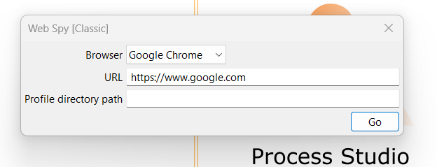

To open go to, Process Studio Toolbar > Tools > Spy > Web Spy [Classic], Web Spy [Classic] pop-up window opens.
Navigate to Web Spy [Classic]
How to Use
  1. Select required Browser from the list. Supported browsers are - Google Chrome, IE Mode 32-bit, IE Mode 64-bit, Internet Explorer, Microsoft Edge and Mozilla Firefox
  2. Enter URL of web application to spy and perform actions.
  3. Specify Profile directory path to save all the directories and click Go.
Web Spy [Classic] dialog
