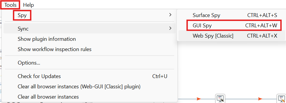

Use GUI Spy to perform a web or Window Automation. To open go to, Process Studio Toolbar > Tools > Spy > GUI Spy, GUI Spy pop-up window opens.
Navigation to GUI Spy window

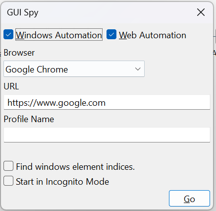

GUI Spy window
If you select Windows Automation checkbox, then you can work with both Windows and Java technologies.
  • Select the Find windows element indices checkbox, if you want to search for the windows elements.
  • Select the Start in Incognito Mode checkbox, if you want to start the browser in the incognito mode. Else, the browser will start in the normal mode.
    Note: The incognito mode will work only if you select the Web Automation checkbox.

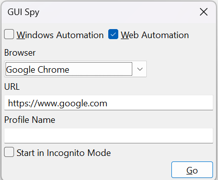

How to Use
Web Automation
  1. Select required Browser from the list. Supported browsers are - Google Chrome, Microsoft Edge and Mozilla Firefox.
  2. Enter URL of web application to spy and perform actions.
  3. Specify Profile directory path to save all the directories and click Go.
  4. Click Start in Incognito Mode checkbox to open browser in Incognito Mode.
  5. Click Go, the selected browser will open with GUI Spy toolbar. Using GUI Spy toolbar, you can build a workflow with GUI Automation plugin steps. For more information on tool icons, see section Appendix: GUI Spy toolbar.

Windows Automation
GUI Spy - Windows Automation
Select Find windows element indices checkbox to find the indices element and click Go

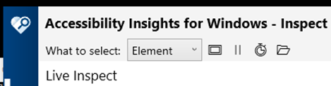

Check Plugin Support:
  • You may check if your target application elements are supported by Windows Application GUI Plugin steps.
  • Verify the target application elements against "Accessibility Insights for Windows" application.
  • You may check only for Element accessibility. Choose the criterion, Element from the list as seen in the following image:
Accessibility Insights for Windows element criterion selection
