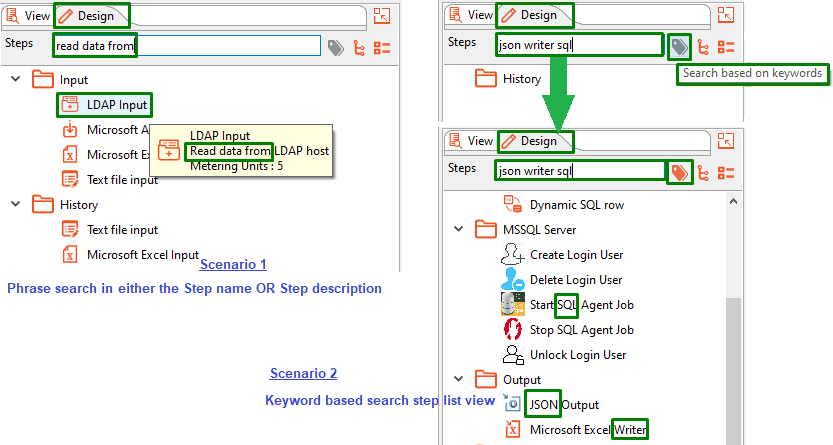

  4. Select the Design tab and choose the step that you want to add to your workflow.
    In the search box in the Design tab, you can enter text such as "read data from", the system checks internally if the entire search text entered is present as-is in the step name or step description.
    • For this search, the full phrase must match exactly the step name or description irrespective of case, that is, if the step name or description contains only a single word like "read" or "data", it will not be included in the search results.
    • If you want to search based on individual words, use the keyword search option. Enter the words in the search box, and then click keyword search. The steps or entries will be listed accordingly. For example, if you enter keywords such as "json", "writer", "sql", in the search box, then all steps having the words are listed in the Design tab.
    Design tab search scenarios view

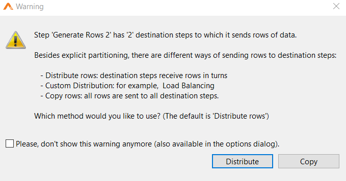

    A warning appears if you try to create a workflow having mixed layouts, that is, input steps with varying data types or varying number of fields. The mixed layout will cause steps to fail because fields are not received as expected or the data type changes unexpectedly.
    If a step sends outputs to more than one step, the data can be copied to each step or distributed among them.

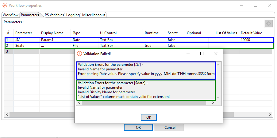

    ParametersNote:
    You will see a Validation Failed dialog if you have made any invalid entries in the tab. The dialog lists all invalid entries and provides suggestions as applicable.

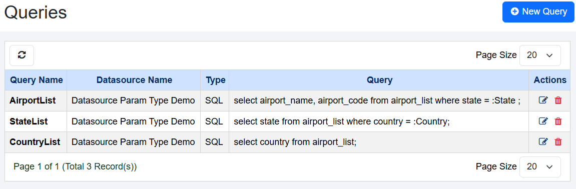

    For example, in the following figure, a query named AirportList has been defined on the server. Consequently, this exact value is entered into the Process Studio configuration to bind the parameter to the correct data source.
    alt text
    Queries defined on AutomationEdge Server

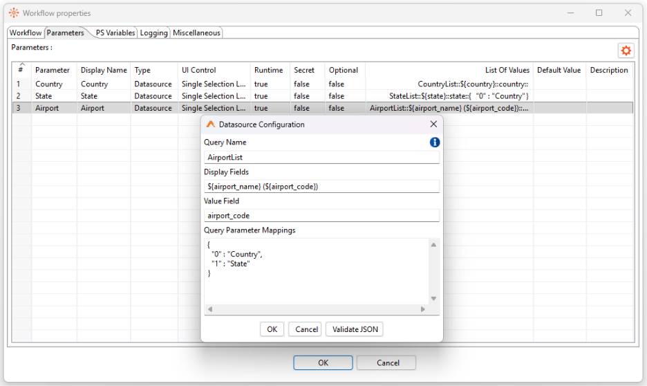

    Query Name
    The Query Name field establishes the critical link between the workflow parameter in Process Studio and the SQL logic defined on the Automation Edge server. It tells the system specifically which pre-defined dataset to retrieve.
    To configure this, enter the name of the query exactly as it is listed in the AEUI Queries tab. This input acts as a strict identifier; the value provided here must match the server-side definition precisely—including casing and spacing—or the data retrieval will fail.
    Display Fields
    The Display Fields setting controls the visual label presented to the user in the service catalog dropdown list. This configuration allows you to format raw database values into user-friendly text, ensuring that selection options are easy to read and identify.
    To populate this field, use the notation ${ColumnName}, where ColumnName corresponds exactly to a column header in your database table. You must refer to your database schema to ensure the column name is spelled correctly.

    Value Field
    The Value Field determines the actual data that the system captures and processes when a user selects in the catalog. While the Display Field optimizes the user interface with readable text, the Value Field ensures that the backend workflow receives the correct technical identifier required for execution.
    Configuration
    To configure this field, enter the exact database column name that contains the data intended for processing .
    - Syntax: Unlike the Display Field, do not use the $ notation or any special formatting. Simply input the raw column name.
    - Implementation: As illustrated in Figure, the value airport_code is entered into the Value Field. This tells the system to read from that specific column.
    Functional Example
    By mapping the value field correctly, you separate the user interface from the data logic:
    - User Selection (Display): The user selects Los Angeles International Airport (LAX).
    - System Input (Value): Because of the configuration in Figure, the workflow receives the value LAX (the data stored in the airport_code column) to use in subsequent automation steps.
    Query Parameter Mappings
    The Query Parameter Mappings field is used to define dynamic dependencies between Datasource parameters. This configuration creates "cascading dropdowns," where the options available in one list change based on the selection made in a previous list.
    This feature allows you to build a hierarchy (e.g., Country -> State -> Airport). Users must select a value in the parent field before the dependent child field becomes active.
    Configuration Logic
    To establish this relationship, you must enter a JSON object that maps the hierarchy levels to the specific parameter names defined in your workflow.
    - Hierarchy Index (Key): Represents the level of the parent parameter. A lower number (e.g., "0") indicates a higher-level root parent (like Country), while a higher number (e.g., "1") indicates a strictly dependent parent (like State).
    - Parameter Name (Value): The exact name of the parent parameter this field depends on.
    Strict Syntax Requirements
    This field requires valid JSON format. You must enclose both the Key (Index) and the Value (Parameter Name) in double quotes (""). Failure to use double quotes will cause the configuration to fail.
    Configuration Example
    In the scenario shown in Figure, we are configuring the Airport parameter. Because the list of airports depends on the State, and the State depends on the Country, we must map both dependencies.
    1. Define the Mapping: Enter the following JSON structure into the mappings field:
    JSON <br/> { <br/> "0": "Country", <br/> "1": "State" <br/> }
    2. System Interpretation:
    * "0": "Country" tells the system that Country is the root filter.
    * "1": "State" tells the system that State is the secondary filter.

    These mappings correspond directly to the SQL definitions shown in Figure. The SQL query for the Airport list expects specific inputs (like: State); the JSON mapping ensures those inputs are passed correctly from the user's previous selections.

    - Query Definition: An SQL query named AirportList is created on the Automation Edge server. This query acts as the data fetcher.

    In Process Studio, the Airport parameter is configured to consume this data:
    - Query Name: The value AirportList is entered to target the specific server-side query.
    - Display Fields: The format ${airport_name} (${airport_code}) is used. This instruction tells the system to combine the readable name with the technical code, wrapped in parentheses.
    - Value Field: The column airport_code is specified. This ensures that while the user reads the full name, the system processes only the unique 3-letter code.
    - Mappings: The JSON mapping {"0": "Country", "1": "State"} is applied, ensuring the airport list only populates after the user selects a Country and State.

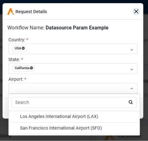

    3. The User Experience
    The result of this configuration appears in the Service Catalog request form.
    alt text
    Datasource configuration reflected on Catalogue Request popup
    - Visual Output: Because of the Display Field configuration, the user sees a descriptive, user-friendly entry: Los Angeles International Airport (LAX).
    - System execution: When the user selects this option, the system ignores the descriptive text and captures the value LAX (based on the Value Field setting). This code is then passed to the workflow for accurate backend processing.
    This separation of visual presentation and technical execution allows for a seamless user experience without compromising the precision required for automated workflows.

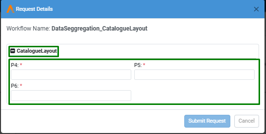

    Parameter Configuration ()Order and group the parameters to be viewed during request submission.
    The option is available only in the main workflow or process and is applicable only for runtime parameters.
    NOTES: The settings you configure in Process Studio will appear in the AE server in the following two menus:
    - CatalogueSubmit Request
    - Schedules
    When you click , the Parameter Configuration dialog appears. It displays the list of parameters entered in the Workflow properties dialog. You can view the toolbar in the dialog.

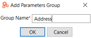

    i. Select to add a new group. In the Add Parameter Group dialog, enter the name of the group.
    ii. Select the parameters to drag and drop to the group.
    You can create nested-groups up to three levels.
    iii. Right-click on the group name, the contextual menu appears. Select Rename or F2 or to rename the group and Delete or DEL or to delete the group.
    iv. To expand or collapse the groups, select or respectively on the toolbar.
    If you want to view a single column layout of parameters in AE UI, select the Single Column Layout checkbox. The view in AE UI appears as follows:
    Single column layout parameter view
    Else, clear the checkbox to have a double column layout.
    Double column layout parameter view
    You can also group the parameters, if required. The view in AE UI appears as follows:
    Double column layout view: Grouped parameters

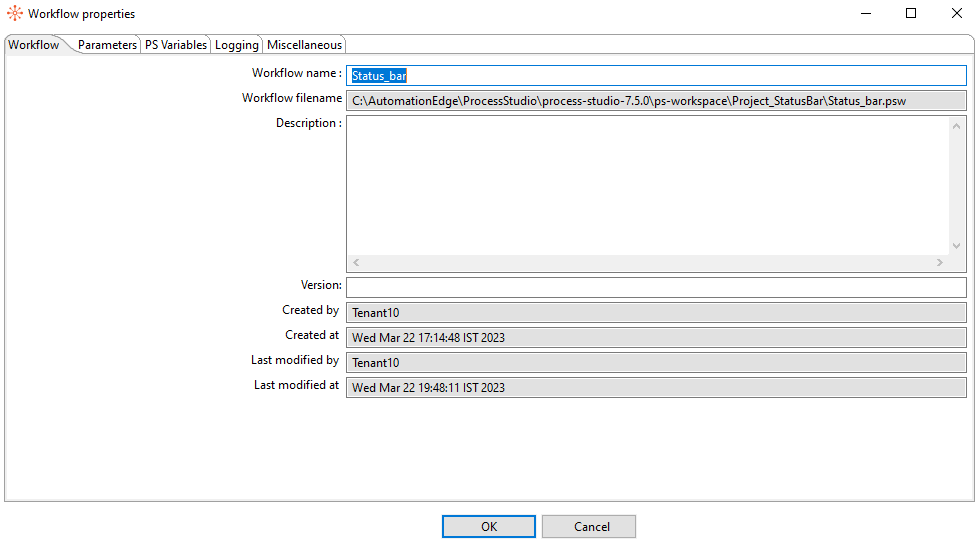

    PS Variables
    NameEnter the name of the variable.
    DescriptionEnter a short description of the variable.
    ScopeChoose if the variable will be Local or Global.
    Default ValueEnter a default value.
    LoggingNOTE: Logging is enabled only if the selected workflow is the main workflow.
    ConnectionSelect the database connection you are using for logging OR click New to configure a new connection.
    Log table schemaSpecify the schema name, if supported by your database. Else, leave blank to take default schema name.
    Log table nameDisplays the name of the log table. The data field is read-only.
    NOTE: For the workflow or process metrics data, table name is Workflow_Process_Log and for the step metrics data, table name is Step_Entry_Log.
    Purge older records (in days)Specify the number of days for which the old log entries in the table will be kept before they are deleted.
    Logging interval (seconds)Specify the interval in which logs are written to the database.
    NOTE: Logging intervals are not available for step log table.
    Log size limit in linesSpecify the number of lines that are stored in the LOG_FIELD (when selected under Fields to Log).
    NOTES:
    - The step log table stores Enable the LOG_FIELD. The logging details in a long text field (CLOB) is stored When the LOG_FIELD is enabled, it will store the logging details in a long text field (CLOB).
    - Logging intervals are not available for step log table.

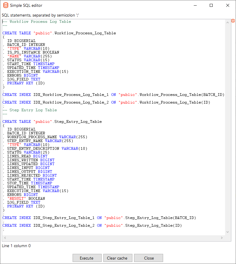

    LoggingIn the Logging tab, the following two options are available on the left pane: Workflow and Step. Select either Workflow or Step, and view the list of fields and their description, respectively. The fields listed for Workflow or Step are available to log step metrics data.
    Click Create Table and create a new database table, such as Workflow_Process_Log_Table and Step_Entry_Log_Table.
    In the result window, click Execute. The tables are created.
    NOTE: Creation of the tables is a one-time activity.
    MiscellaneousNOTE: This tab is available in the Workflow properties dialog only.
    Nr of rows in rowsetEnter the size of the buffers between the connected steps in a workflow.
    NOTE: Avoid changing this parameter unless it runs low on memory.
    Show a feedback row in workflow steps?Select the checkbox to add a feedback entry into the log file while the workflow is running. It is enabled and configured to display a feedback record every 5000 rows by default.
    Feedback sizeEnter the number of rows to process before entering a feedback entry into the log. Set this higher when processing large amounts of data to reduce the log file information amount.
    Make the workflow database transactionalSelect the checkbox to make the workflow database transactional. Transaction data always has a time dimension, a workflow ID, and refers to one or more objects, such as reference data like workflow configuration ID.

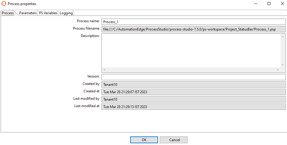

  5. Right-click on the canvas and select Properties or select CTRL + T. The Process properties dialog appears.
    You can also open the Process properties dialog through EditSettings… or double-click anywhere in the canvas.
  6. Specify the required details in the following tabs: Process, Parameters, PS Variables, and Logging.
    FieldDescription
    Process
    Process nameEnter a new name for the process.
    NOTE: If you modify the name of an existing process, then the name is also updated in the Project Explorer.
    Process filenameDisplays the path of the process.
    DescriptionEnter a description of the process.
    VersionEnter the version number.
    Created byDisplays the name of the user who created the process.
    Created atDisplays the date and time of process creation.
    Last modified byDisplays the name of the user who last modified the process.
    Last modified atDisplays the last process modification date and time.
    For details about the Parameters, PS Variables, and Logging tabs, see Create a workflow.
