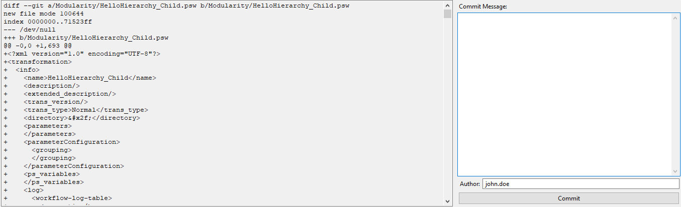

To commit a file:
  1. In the Changed files pane, select the checkbox against the files that you want to commit.
  2. Select individual file to view its details in the stage pane, then enter a comment in Commit Message.
    Stage pane view
  3. Click Commit. The changes are committed to the working branch.
  • The commit action aborts, if you click Commit without adding a comment in the Comment Message box.
  • To commit all files at once, click the Select All checkbox.
  • In the SVN perspective, committing the file pushes the updates to the remote repository.
  • In Git perspective, click Push, to commit the updated branch to the repository. The changes are now available in the remote repository.
