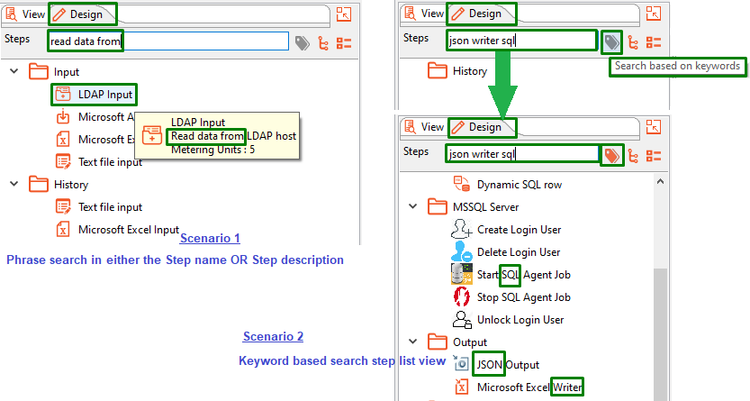

    In the search box in the Design tab, you can enter text such as "read data from", the system checks internally if the entire search text entered is present as-is in the step name or step description.
    • For this search, the full phrase must match exactly the step name or description irrespective of case, that is, if the step name or description contains only a single word like "read" or "data", it will not be included in the search results.
    • If you want to search based on individual words, use the keyword search option. Enter the words in the search box, and then click keyword search. The steps or entries will be listed accordingly. For example, if you enter keywords such as "json", "writer", "sql", in the search box, then all steps having the words are listed in the Design tab.
    Design tab search scenarios view
    Figure 57: Design tab search scenarios view

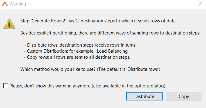

    If a step sends outputs to more than one step, the data can be copied to each step or distributed among them.

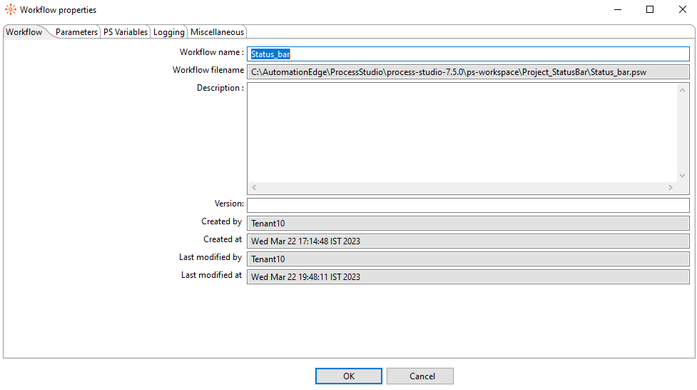

  6. Right-click on the canvas and select Properties or select CTRL + T. The Workflow properties dialog appears.
    Figure 58: Workflow properties dialog
    You can also open the Workflow properties dialog through EditSettings… or double-click anywhere in the canvas.
  7. Specify the required details in the following tabs: Workflow, Parameters, PS Variables, Logging, and Miscellaneous.
    FieldDescription
    Workflow
    Workflow nameEnter a new name of the workflow.
    NOTE:
    If you modify the name of an existing workflow, then the name is also updated in the Project Explorer.
    Workflow filenameDisplays the path of the workflow.
    DescriptionEnter a description of the workflow.
    VersionEnter the version number.
    Created byDisplays the name of the user who created the workflow.
    Created atDisplays the date and time of workflow creation.
    Last modified byDisplays the name of the user who last modified the workflow.
    Last modified onDisplays the last workflow modification date and time.

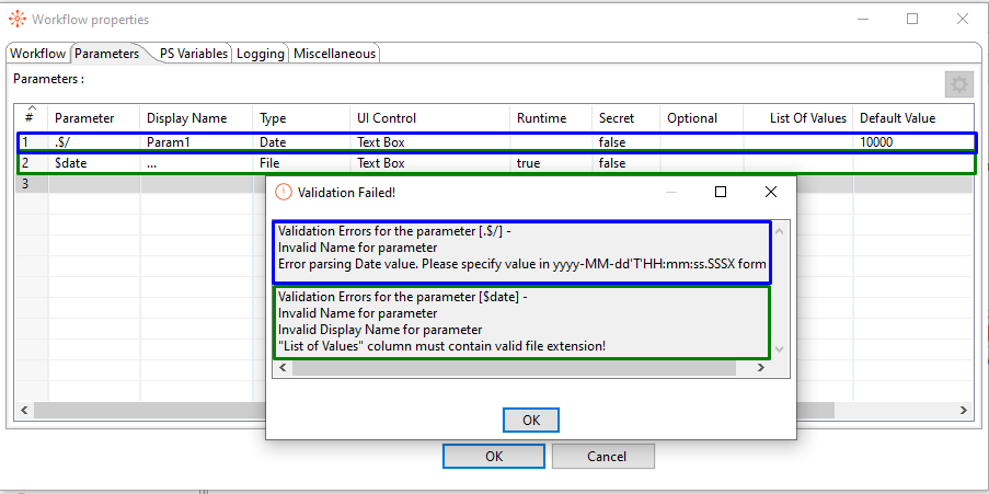

    ParametersNote:
    You will see a Validation Failed dialog if you have made any invalid entries in the tab. The dialog lists all invalid entries and provides suggestions as applicable.
    Figure 58: Workflow properties → Parameters → Validation failed dialog

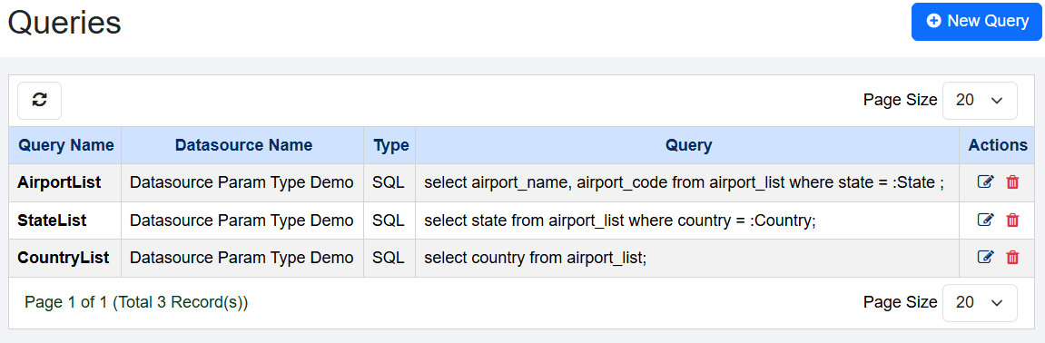

    For example, in the following figure, a query named AirportList has been defined on the server. Consequently, this exact value is entered into the Process Studio configuration to bind the parameter to the correct data source.
    alt text
    Figure 58: Snapshot of queries defined on AutomationEdge Server visible on AEUI on Reports -> Queries tab

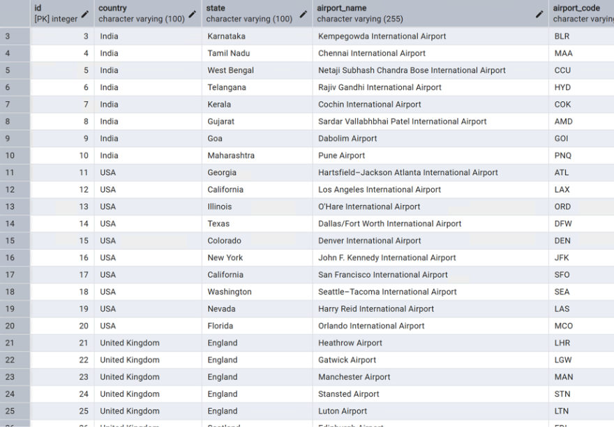

    Display Fields
    The Display Fields setting controls the visual label presented to the user in the service catalog dropdown list. This configuration allows you to format raw database values into user-friendly text, ensuring that selection options are easy to read and identify.
    To populate this field, use the notation ${ColumnName}, where ColumnName corresponds exactly to a column header in your database table. You must refer to your database schema to ensure the column name is spelled correctly.

    Figure 59: Snapshot of Database table airport_list

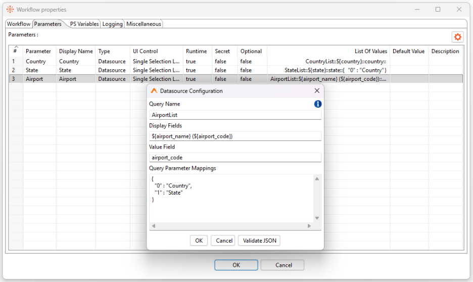

    Figure 60: Snapshot of how Datasource type property is set in Process Studio Parameter
    - Configuration: As seen in the configuration window above, the Display Field is configured using the pattern ${airport_name} (${airport_code}).
    - Result: This configuration dynamically pulls data from both columns and formats it with parentheses.

    - Implementation: As illustrated in Figure 60, the value airport_code is entered into the Value Field. This tells the system to read from that specific column.

    In the scenario shown in Figure 60, we are configuring the Airport parameter. Because the list of airports depends on the State, and the State depends on the Country, we must map both dependencies.
    1. Define the Mapping: Enter the following JSON structure into the mappings field:
    JSON <br/> { <br/> "0": "Country", <br/> "1": "State" <br/> }
    2. System Interpretation:
    * "0": "Country" tells the system that Country is the root filter.
    * "1": "State" tells the system that State is the secondary filter.

    These mappings correspond directly to the SQL definitions shown in Figure 58. The SQL query for the Airport list expects specific inputs (like: State); the JSON mapping ensures those inputs are passed correctly from the user's previous selections.

    1. Data Foundation
    The process begins with the raw data and server definitions.
    - Database: As shown in Figure 59, the database table contains two distinct columns of interest: airport_name (e.g., "Los Angeles International Airport") and airport_code (e.g., "LAX").
    - Query Definition: An SQL query named AirportList is created on the Automation Edge server (Figure 58). This query acts as the data fetcher.

    In Process Studio (Figure 60), the Airport parameter is configured to consume this data:
    - Query Name: The value AirportList is entered to target the specific server-side query.
    - Display Fields: The format ${airport_name} (${airport_code}) is used. This instruction tells the system to combine the readable name with the technical code, wrapped in parentheses.
    - Value Field: The column airport_code is specified. This ensures that while the user reads the full name, the system processes only the unique 3-letter code.
    - Mappings: The JSON mapping {"0": "Country", "1": "State"} is applied, ensuring the airport list only populates after the user selects a Country and State.

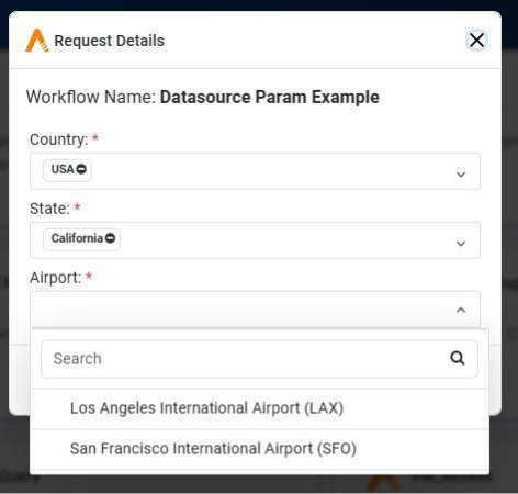

    3. The User Experience
    The result of this configuration appears in the Service Catalog request form.
    alt text
    Figure 61: Snapshot of how Figure 60 configuration reflects on Catalogue Request Popup
    - Visual Output: Because of the Display Field configuration, the user sees a descriptive, user-friendly entry: Los Angeles International Airport (LAX).
    - System execution: When the user selects this option, the system ignores the descriptive text and captures the value LAX (based on the Value Field setting). This code is then passed to the workflow for accurate backend processing.
    This separation of visual presentation and technical execution allows for a seamless user experience without compromising the precision required for automated workflows.

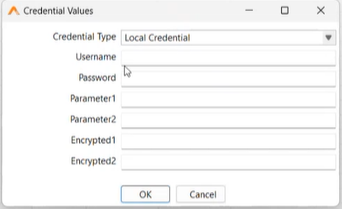

    Select Type as Credential, and then click the Default Value field, to open the Credential Values dialog.
    Figure 59: Credential Values dialog
    The Credential Type list contains the list of all AE server credentials. However, the default value is the current credential.

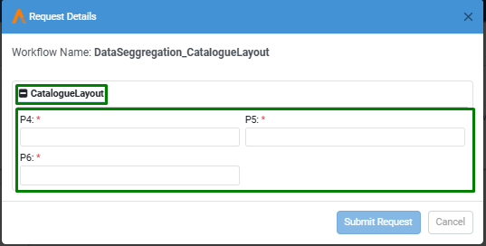

    Parameter Configuration ()Order and group the parameters to be viewed during request submission.
    The option is available only in the main workflow or process and is applicable only for runtime parameters.
    NOTES: The settings you configure in Process Studio will appear in the AE server in the following two menus:
    - CatalogueSubmit Request
    - Schedules
    When you click , the Parameter Configuration dialog appears. It displays the list of parameters entered in the Workflow properties dialog. You can view the toolbar in the dialog.

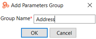

    i. Select to add a new group. In the Add Parameter Group dialog, enter the name of the group.
    ii. Select the parameters to drag and drop to the group.
    You can create nested-groups up to three levels.
    iii. Right-click on the group name, the contextual menu appears. Select Rename or F2 or to rename the group and Delete or DEL or to delete the group.
    iv. To expand or collapse the groups, select or respectively on the toolbar.
    If you want to view a single column layout of parameters in AE UI, select the Single Column Layout checkbox. The view in AE UI appears as follows:
    Single column layout parameter view
    Else, clear the checkbox to have a double column layout.

    Double column layout parameter view
    You can also group the parameters, if required. The view in AE UI appears as follows:
    Double column layout view: Grouped parameters

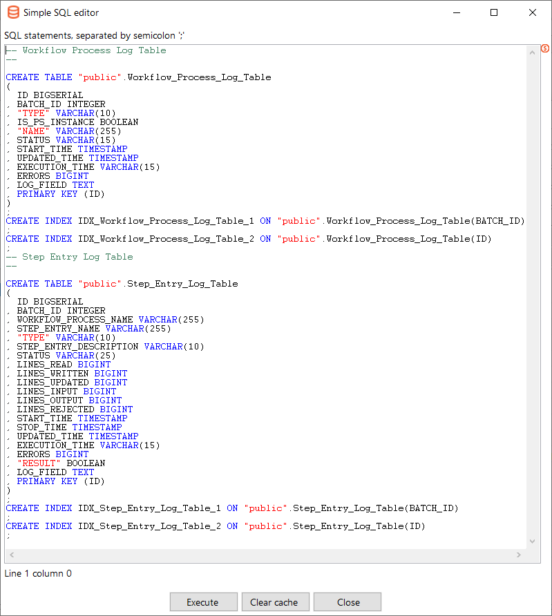

    LoggingIn the Logging tab, the following two options are available on the left pane: Workflow and Step. Select either Workflow or Step, and view the list of fields and their description, respectively. The fields listed for Workflow or Step are available to log step metrics data.
    Click Create Table and create a new database table, such as Workflow_Process_Log_Table and Step_Entry_Log_Table.
    In the result window, click Execute. The tables are created.
    NOTE: Creation of the tables is a one-time activity.
    MiscellaneousNOTE: This tab is available in the Workflow properties dialog only.
    Nr of rows in rowsetEnter the size of the buffers between the connected steps in a workflow.
    NOTE: Avoid changing this parameter unless it runs low on memory.
    Show a feedback row in workflow steps?Select the checkbox to add a feedback entry into the log file while the workflow is running. It is enabled and configured to display a feedback record every 5000 rows by default.
    Feedback sizeEnter the number of rows to process before entering a feedback entry into the log. Set this higher when processing large amounts of data to reduce the log file information amount.
    Make the workflow database transactionalSelect the checkbox to make the workflow database transactional. Transaction data always has a time dimension, a workflow ID, and refers to one or more objects, such as reference data like workflow configuration ID.

  3. Select the Design tab and choose the entry that you want to add to your process.
    In the Design tab, you can:
    • Click keyword search to search for entries using keywords specified in the step name or the description. For example, if you enter keywords such as abort, ftp in the search box, then all steps having the words are listed in the Design tab.
    • To expand or collapse the step view, click expand or collapse respectively.

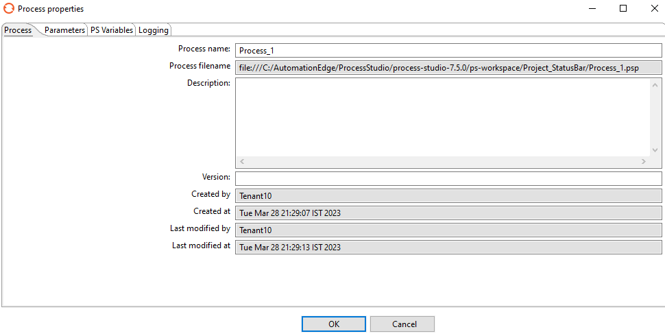

  5. Right-click on the canvas and select Properties or select CTRL + T. The Process properties dialog appears.
    Figure 60: Process properties dialog
    You can also open the Process properties dialog through EditSettings… or double-click anywhere in the canvas.
  6. Specify the required details in the following tabs: Process, Parameters, PS Variables, and Logging.
    FieldDescription
    Process
    Process nameEnter a new name for the process.
    NOTE: If you modify the name of an existing process, then the name is also updated in the Project Explorer.
    Process filenameDisplays the path of the process.
    DescriptionEnter a description of the process.
    Created byDisplays the name of the user who created the process.
    Created atDisplays the date and time of process creation.
    Last modified byDisplays the name of the user who last modified the process.
    Last modified atDisplays the last process modification date and time.
    For details about the Parameters, PS Variables, and Logging tabs, see Create a workflow.
