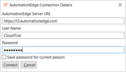

When you start Process Studio for the first time an AutomationEdge Connection details pop-up window also appears.
Provide the following AutomationEdge Server connection details:
Enter the AutomationEdge Server cloud instance URL:
- URL for Production Instance: https://ondemand.automationedge.com
- URL for Trial/RPAaaS Instance: https://t4.automationedge.com
- URL for Training Instance: http://t3.automationedge.com
In the User Name and Password fields, enter the user’s name and password.
Click Connect. You get connected to the AutomationEdge server.
To save the password for the current session, select the Save password for current session checkbox. Saving the password ensures that you don’t need to enter password for every activity that needs to communicate with the server, such as plugin synchronization and publishing workflows.
