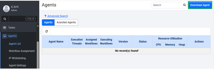

  1. In the menu, click Agents -> Agent List. The Agents page appears.
CGS
  1. Click Download Agent. The Download Agent dialog appears.

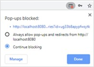

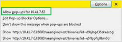

  • If you see pop-up blockers, when downloading the agent, select the option to always allow pop-ups from AutomationEdge.
Pop-up in Chrome

Pop-up in Firefox

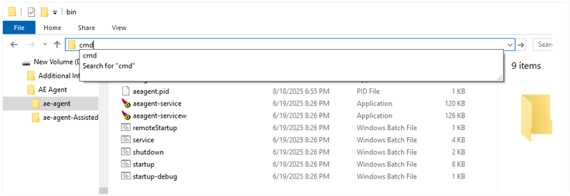

After downloading the agent, extract the downloaded zip file in your preferred location and run startup.bat from ae-agent\bin folder.
To start the agent:
  1. In Windows explorer, go to the ae-agent\bin folder. In the address bar type cmd.

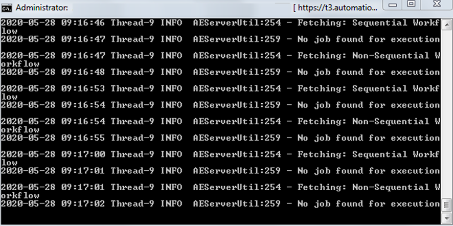

  2. Type the following at the command prompt and press Enter. The agent starts up.
    C:\CLOUD\ae-agent\bin>startup.bat
    CGS

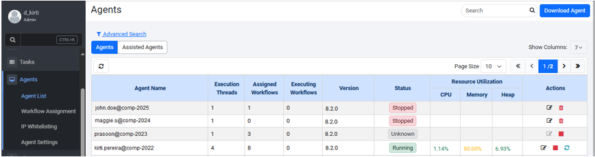

Check if Agent is running on AutomationEdge Server UI
In AutomationEdge, go to Agents -> Agent List, and check if the agent you started is appearing on the Agents page.
Hover over Agent Name to see the Agent details, including Agent Name, IP, hostname, MAC address, and JRE details – JRE version and if agent uses bundled JRE.
