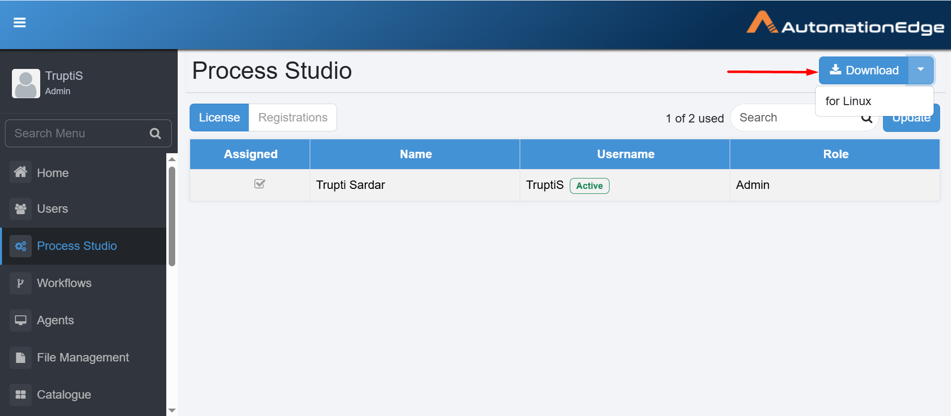

Download Process Studio
Download button(/dropdown) on Process Studio menu can download Process Studio for: Windows or Linux.
Prerequisites
Process Studio license is assigned to the user. For assigning licenses, see Process Studio: Assign License in AutomationEdge User’s guide.
To download the Process Studio:
In AutomationEdge, go to Process Studio menu. On the Process Studio Registrations page, click Download.
CGS
The downloaded Process Studio folder is suffixed with the Tenant Organization Code (org code). For example, Process-Studio-CLOUD_TRIAL.zip when org code is CLOUD_TRIAL.
The downloaded Process Studio is bundled with Java for the corresponding OS.
