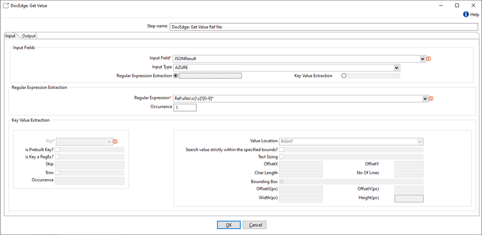

RegEx Extraction with Text as Input (Same configuration can be used for PDF, Google Vision or Azure as Input)
Extraction of value using RegEx is possible with all input types. User needs to specify the input source, source type and a valid RegEx to get the proper output

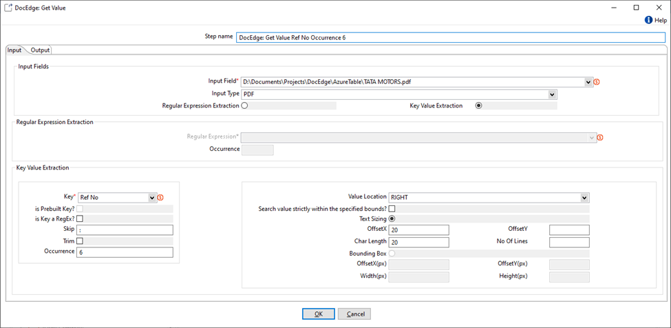

Key Value Extraction from PDF
Extraction of value from a digital PDF is possible by specifying a search word/phrase as key. The key can be a plain string or a regular expression. User needs to also specify the location of value with respect to key as well as other parameters like X/Y offsets, length and/or no. of lines.

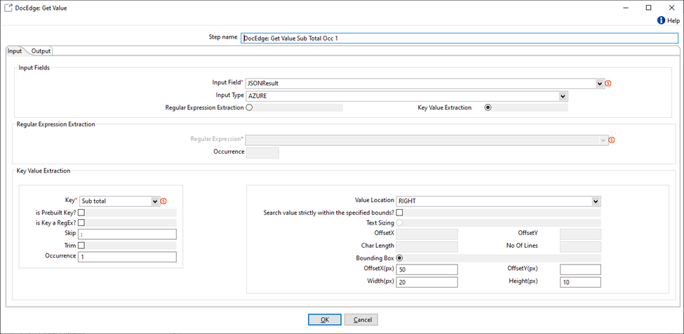

Key Value Extraction from Google Vision OR Azure
To extract a value from an image, it is first passed to google vision or Azure OCR. The JSON output from these OCRs is then considered as input for “Get Value” plugin. In this case also the extraction is done by specifying a search word/phrase as key. The key can be a plain string or a regular expression. User needs to also specify the location of value with respect to key as well as other parameters like X/Y offsets, width and/or height.

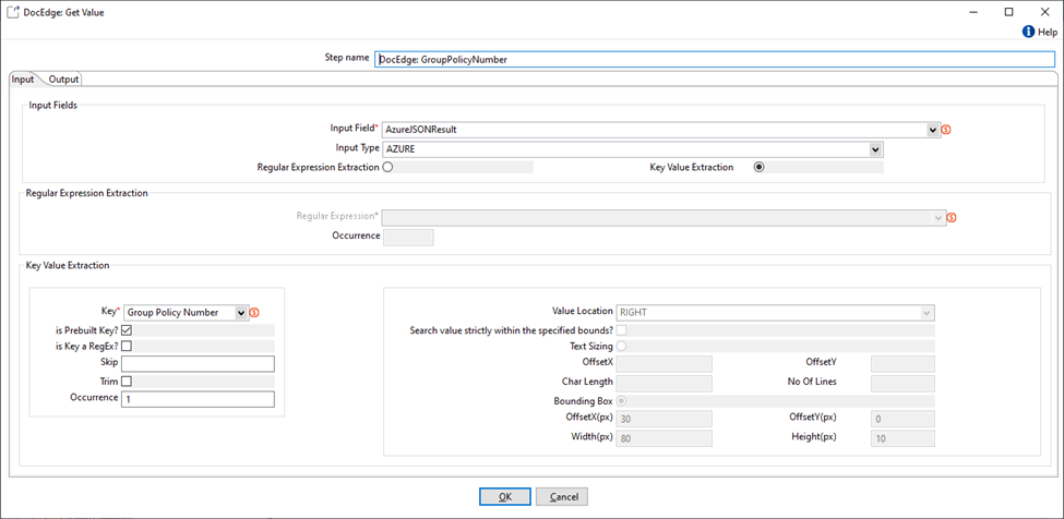

Key Value Extraction from Azure using prebuilt keys
To extract a value from an image, it is first passed to Azure OCR with parameter features= keyValuePairs. In this case also the extraction is done by specifying a search word/phrase as key. User needs to check the checkbox “is Prebuilt Key?” to use prebuilt keys feature. Other configurations for finding the value are not applicable here.

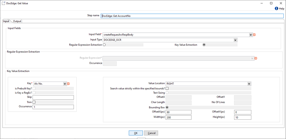

Key Value Extraction from other OCR engines
To extract value from an image, it is first passed to OCR Engine. The JSON output from this OCR is then considered as input for “Get Value” plugin. It is a prerequisite that this OCR output should be in the same format as AZURE OCR. The input type selected here is DOCEDGE_OCR. In this case also the extraction is done by specifying a search word/phrase as key. The key can be a plain string or a regular expression. User needs to also specify the location of value with respect to key as well as other parameters like X/Y offsets, width and/or height

| Regular Expression Extraction | Choose this radio button to utilize a RegEx pattern for searching for a value. It is selected by default. The field is mandatory. |
| Key Value Extraction | Choose this radio button to utilize config information like Key, Location, Offset etc. to find value. This option is not available when the input source is Text. The field is mandatory. |
| Regular Expression Extraction | This section below will be enabled only when the 'Regular Expression Extraction' radio button is selected. |
| Regular Expression | Regular expressions will be used instead of a key value configuration. If found, the matched text will be returned as output. |
| Occurrence | If Regular Expression returns multiple matches, occurrence field decides which match is to be returned. If “Occurrence” field is empty all matches will be returned as comma separated string. |

| Is prebuilt key? | This checkbox is added to use Prebuilt Keys from Azure response. It is enabled only when input type = AZURE. When this checkbox is checked, all the value configurations will be disabled. |

| Text Sizing | Select this radio button if you wish to obtain the value for a specific key using its position. This option is available only when the input source is PDF. The field is mandatory. |
| OffsetX | Offset value of x coordinates. The field is mandatory. |
| OffsetY | Offset value of y coordinates. The field is mandatory. |
| Char Length | Specify the length of characters to be extracted as the value for a specific key. The field is mandatory. |
| No Of Lines | Specify the number of lines for the value if it is multi-line text, such as an address. The field is mandatory. |
| Bounding Box | Select the bounding box radio button if you wish to use coordinates for the text value. This option is available only when the input source is Google Vision or Azure. The field is mandatory. |
| OffsetX(px) | X coordinate value in pixels. The field is mandatory. |
| OffestY(px) | Y coordinate value in pixels. The field is mandatory. |
| Width(px) | The width of the bounding box for a particular value, measured in pixels. The field is mandatory. |
| Height(px) | The height of the bounding box for a particular value, measured in pixels. The field is mandatory. |
