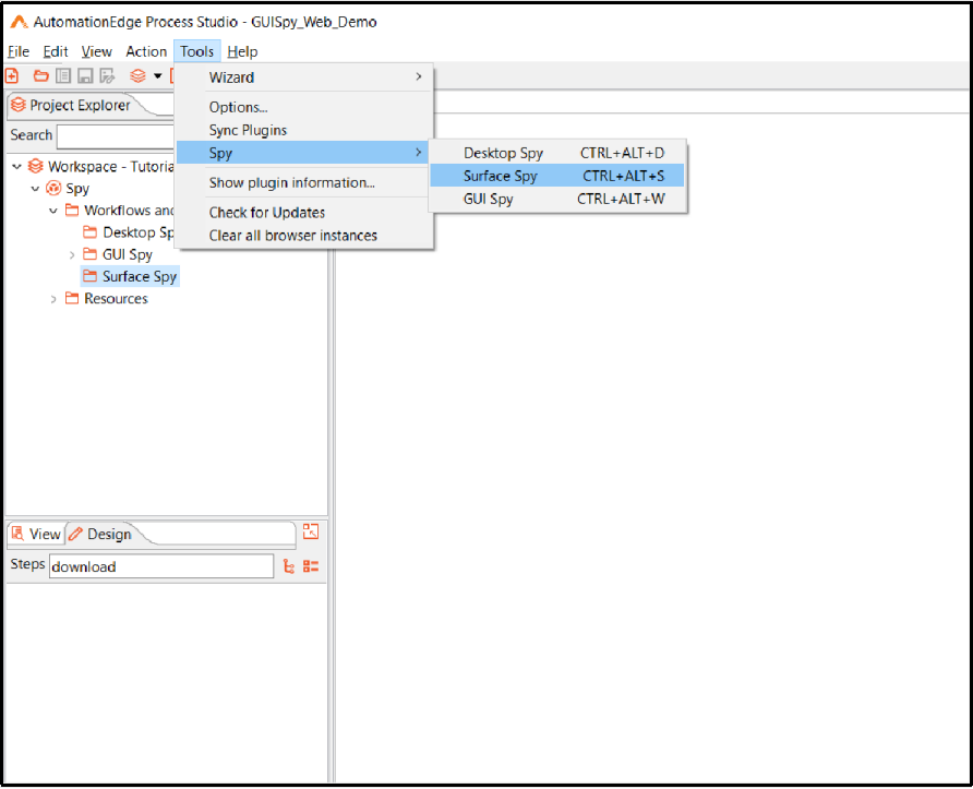

  1. To launch Surface Spy, click Tools -> Spy -> Surface Spy menu option.
  2. A warning message to create a workflow displays. The default workflow name is Workflow_1. Click OK.
  3. Surface Spy opens in the foreground to Process Studio as seen in the snapshot below.

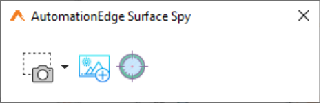

  4. The three icons on Surface Spy are explained below and implemented in the steps that follow.
Icon on Surface SpyDescription
spyOn hovering over the icon it shows the name of the icon - Capture Image.If you click on the drop down arrow it shows three options,
- Capture now If you click on the Capture Image icon or select Capture now from the drop down list, you see a + mouse pointer that can be used to outline any area on the screen.
- Capture in 3 Seconds If you select Capture in 3 Seconds from the drop down list you see a + mouse pointer after 3 seconds, that can be used to outline any area on the screen.
- Capture in 10 Seconds
If you select Capture in 10 Seconds from the drop down list you see a + mouse pointer after 10 seconds, that can be used to outline any area on the screen. This is useful if the area to outline is not on the screen immediately but you need less than 3 or 10 seconds as mentioned in the two points above, to navigate to a desired screen.
Note: If you select a small icon or image, for example,capture a icon in Process Studio, then the captured image is enlarged in the AutomationEdge Surface Spy or Surface Click dialog, and it will appear aligned in the middle. For example, the view in the AutomationEdge Surface Spy dialog appears as follows: JRE icon
spyClick to upload an image from your local system.

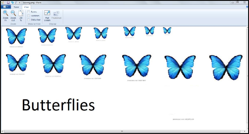

  1. Capture Image on the paint document as shown in the screenshot below. Let us assume the image on the top left corner to be the base image with a size 100%. The images on the right are smaller images with 10% reduction in size each. The images in the bottom row are in ascending order of size ascending by 10% each.
JRE icon

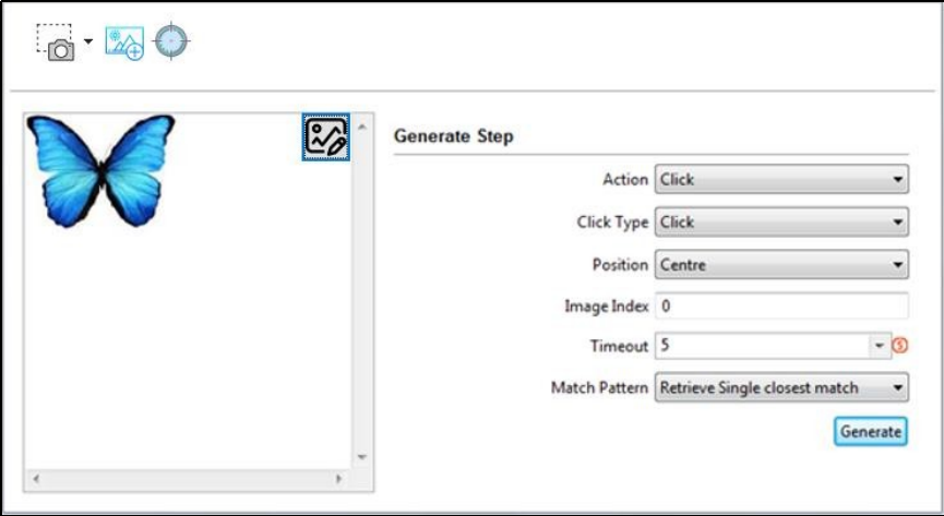

  1. Once you capture an image or pattern, the AutomationEdge Surface Spy window expands, as shown below. In this case, we have captured the third image from the left in the top line.
JRE icon
  1. Use spy to crop the image, if required before proceeding with step generation.
  2. Generate Step configuration screen options differ depending on the Action chosen.

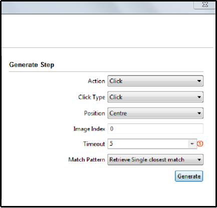

  3. The following screen shows the Generate Step configuration options when Action chosen is Click as seen above also.
spy

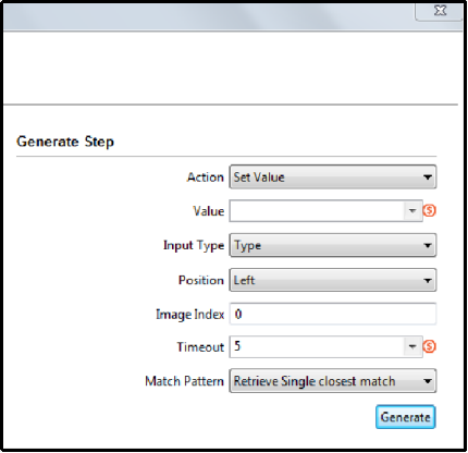

  1. The following screen shows the Generate Step configuration options when Action chosen is Action Set Value.
spy

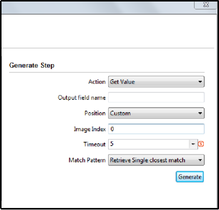

  1. The following screen shows the Generate Step configuration options when Action chosen is Action Get Value.
spy

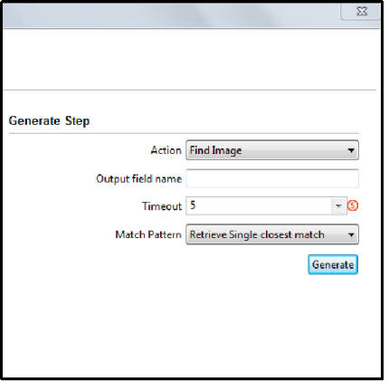

  1. The following screen shows the Generate Step configuration options when Action chosen is Action Find Image.
spy
  1. The following table summarizes all the Generate step options for all Actions types.
Table: Surface Spy Generate Step Options
No.OptionDescription
1ActionThe Action Drop Down has the following options available.
Click: It performs a click action.
Set Value: It performs Set Value on a region/image.
Get Value: It Gets Value from a region/image.
Find Image: It checks for an image and returns true or false.
2Click TypeThe Click Type Drop Down has the following options available. This option is available if Action chosen in Click.
Click: It performs left click action.
Right Click: It performs right click action.
Double Click: It performs double-click action.
Middle Click: It performs left Middle click action. Mouse Move: It performs Mouse Move action.
3ValueSpecify a Value to be set on a region/image.
4Output field name (for Action Get Value)This field is active when the Action chosen is Get Value. Provide a field name to hold the value retrieved from a region.
5Output field name (for Action Find Image)This field is active when the Action chosen is Find Image. Provide a field name to hold a Boolean value(Y/N) indicating whether the image was found or not.
6PositionThe Position Drop Down has the following options.Perform the Action chosen above at the position selected here.
Left: Center Left position of the Image.
Right: Center Right position of the Image. Center: Center of the Image.
Custom: The relative position from the entire Image, it could be anywhere on the screen. If the relative position of the relative element to click is closer, it is preferable.
7Image IndexImage Index is retrieved once an image is clicked from the selected images.
8TimeoutSpecify this is the Timeout for step execution. By default, timeout is 5 seconds.
9Match PatternThe Match Pattern Drop Down has the following options available.
- Retrieve Single closest match
- Retrieve Multiple close matches
- Retrieve All close match
10Button: GenerateClick Generate button to generate the step with the configurations above.

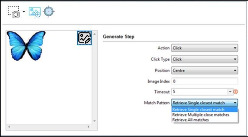

  1. The Match Pattern drop-down field has the following options as shown below,
    • Retrieve Single closest match
    • Retrieve Multiple close matches
    • Retrieve All close match
JRE icon
  1. Once you outline an area using Capture Image the next step is to Locate Images. Clicking on Locate images icon searches for matching images (/patterns) depending on the Match Pattern chosen as mentioned above.
  2. Let us select Retrieve Single closest match in the match Pattern drop down. Now click on Locate Images (spy ) icon. It gives an error Multiple Match Found as it has found more than one close matches.
info
We Click on an image to select and press Esc key to exit.
  1. Let us select Retrieve Multiple close matches in the match Pattern drop down. Now click JRE icon
JRE icon
  1. Let us select Retrieve All matches in the match Pattern drop down. Now click on Locate Images (JRE icon) icon. It locates All Matches as seen below (not below 50% or above 150% of the original size).
JRE icon
