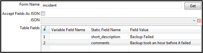

Following, is a sample snapshot of input tab with Table Fields with Static Field Name.
alt text

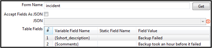

Following, is a sample snapshot of input tab with Table Fields with Variable Field Name. alt text
