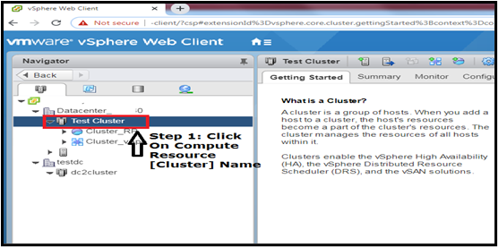

The following screen shots depict how to get the Compute Resource ID of a Cluster Resource Type. i. Select a cluster in the vSphere-vCenter as seen below.

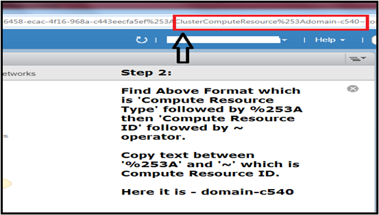

ii.Once the Resource Type i.e. Cluster in this case is selected scroll the URL address bar to locate the Resource Type (ClusterComputeResource in this case). Then pick the Resource ID in between %253A and a ~.

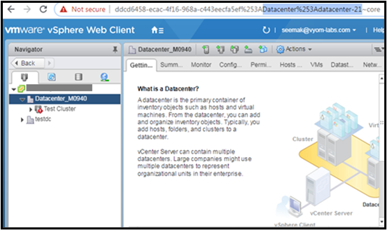

Following are samples of Target ID marked in yellow. Note: that Target ID is is preceded by a %253A and followed by a ~. %253A must be which preceded by the desired Target Location Type.You may copy the Target ID required as marked in yellow below.
| Datacenter | Datacenter%253Adatacenter-21~ |
| VM Folder | Folder%253Agroup-v381~ |
The following screen shots depict how to get the Target ID of a Datacenter Target Location Type. iii. Select a Datacenter in the vSphere-vCenter as seen below. iv. Once the Target Location Type, i.e. Datacenter in this case is selected scroll the URL address bar to locate the Target Location Type (Datacenter in this case). Then pick the Target ID in between %253A and a ~.

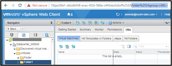

v. Similarly, once the Target Location Type i.e. VM Folder is selected scroll the URL address bar to locate the Target Location Type (Folder in this case). Then pick the Target ID in between %253A and a ~ as seen below.
