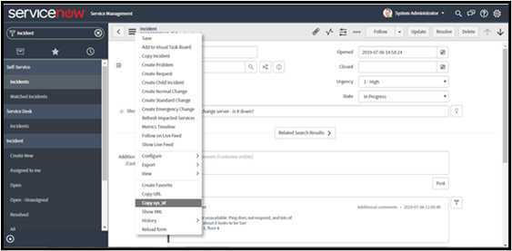

The following screenshot shows that sys_id can be copied by right clicking on a particular record.

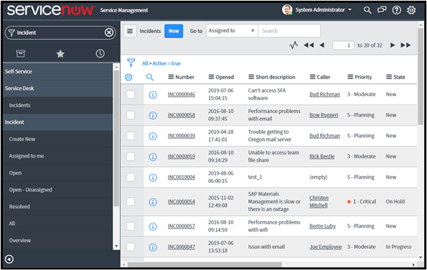

The following is a screen shot of the Incident Application. You can see the filter sign on top of the column headings. It shows the filter Active=True has been applied on All incidents.

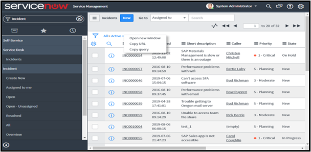

You may right click on the filter and click Copy query to copy the Criteria Query.

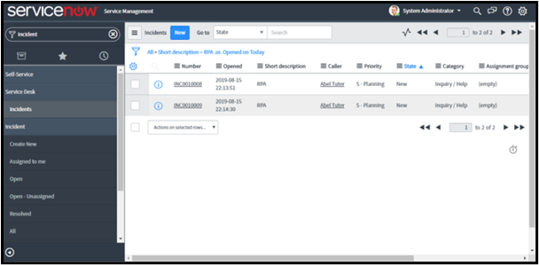

You can now see the filtered list with filter applied: Short_description=RPA or Opened Today.

Right click on the filter and click Copy query.
