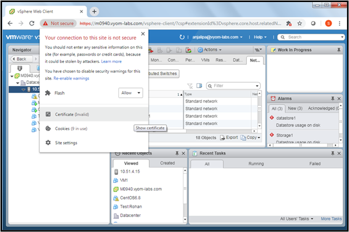

  1. Log in to vCenter Server using specified server name (https:\vmware.example.com) and follow the below procedure to install the certificate.
alt text

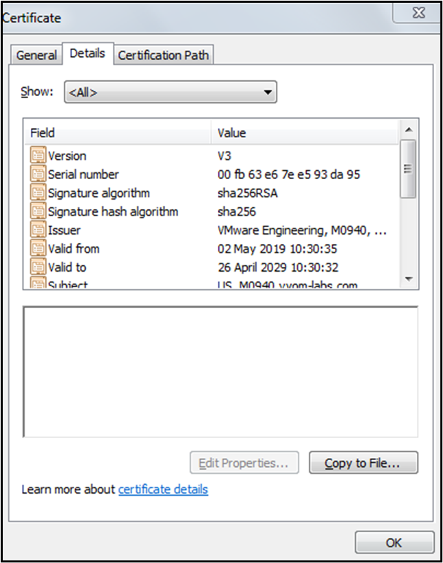

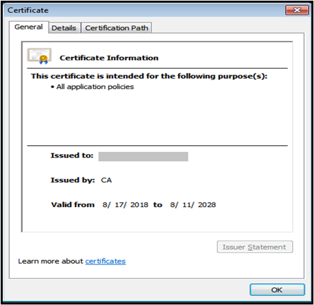

  1. The Certificate Windows opens.
  2. Navigate to the Details tab.
alt text
  1. Click Copy to File button while on Details tab.

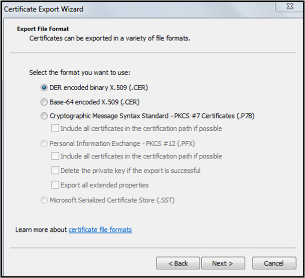

  4. Select the format as shown below.
  5. Click Next.

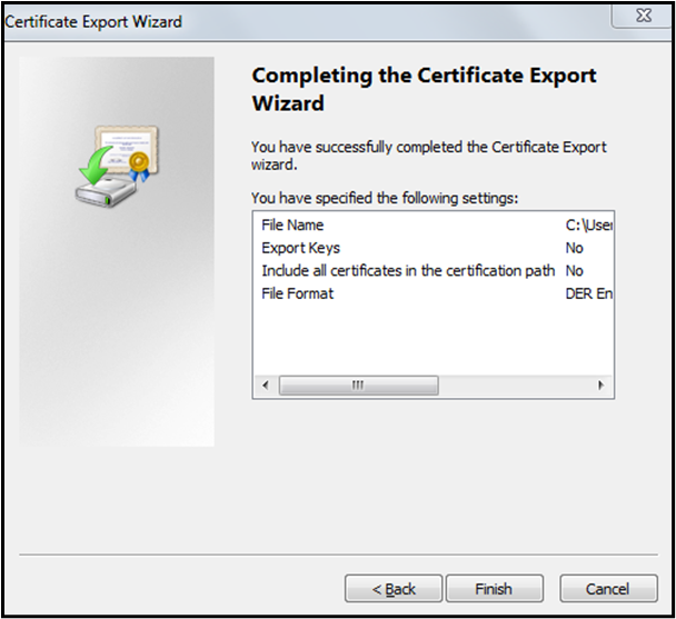

  6. This is the final step: Completing the Certificate Export.
  7. Click Finish.

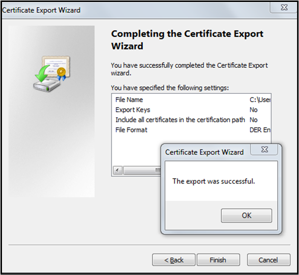

alt text
  1. A pop-up window appears showing the export was successful.
  2. Click OK.
