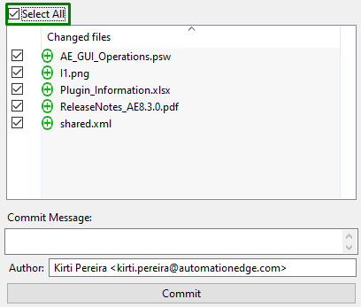

Changed files
In this section, you can work on the files in the repository.
You can view the new or modified files in the Changed files pane. A new file added to the repository has added icon against it. A modified file has changed and removed file has removed icons against it, respectively.

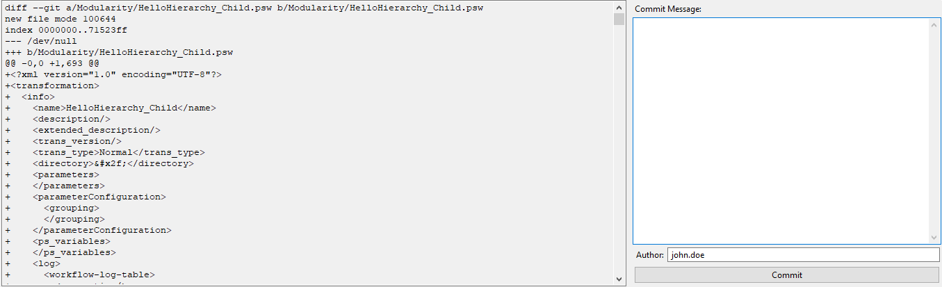

To commit a file:
  1. In the Changed files pane, select the checkbox against the files that you want to commit.
  2. Select individual file to view its details in the stage pane, then enter a comment in Commit Message.
    Figure 78: Stage pane view
  3. Click Commit. The changes are committed to the working branch.
  • The commit action aborts, if you click Commit without adding a comment in the Comment Message box.
  • To commit all files at once, click the Select All checkbox.
