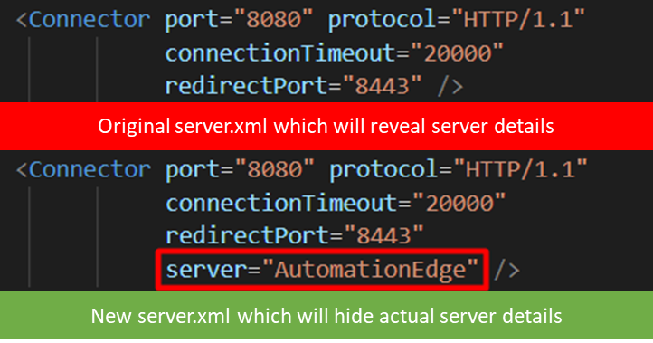

Hide the Tomcat server name and version. Complete the process of hiding the details and then restart the Tomcat server.
To hide Tomcat server name and version:
Go to <Tomcat home>/lib and create the directory org/apache/catalina/util under lib.
In the new directory, create a ServerInfo.properties file, and add an entry for server.info property in the file.
Keep the value for this property blank. For example, server.info=.
- Edit server.xml configuration file available under <Tomcathome>/conf, and add the following details in the Connector node:
The step is optional.
server="AutomationEdge"
Figure 2: Connector node view

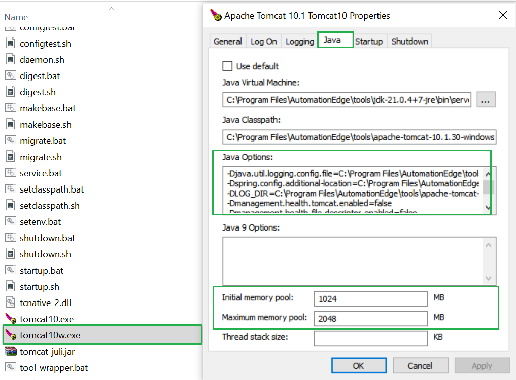

Open the command prompt, go to %TOMCAT_HOME%/bin execute service.bat install. The Tomcat service is installed.
Go to %TOMCAT_HOME%/bin, and select the Tomcat executable, and run it. For example, tomcat10w.exe. Running the executable will allow you to make changes to the Tomcat properties, if required.
In the Java tab, make the following changes:
Java Options section, enter:
\-Dspring.config.additional-location=\<yourPath\>\\AutomationEdge\\aehome\\conf\\ae.properties
\-DLOG_DIR=\<yourPath\>\\AutomationEdge\\tools\\apache-tomcat-10.1.30-windows-x64\\apache-tomcat-10.1.30\\logs
\-Dmanagement.health.tomcat.enabled=false
\-Dmanagement.health.file-descriptor.enabled=false
Change the following properties:
Initial memory pool: 1024 MB*
Maximum memory pool: 2048 MB*
You can increase the allocated memory to higher values depending upon the load on the AE server. For example, if a machine has 8 GB RAM set, the Initial memory pool: 2048 MB* and Maximum memory pool: 4096 MB*.
Figure 3: Apache Tomcat 10.1 Tomcat10 Properties dialog
Remove all details from the Java 9 Options section.

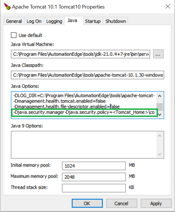

For details about starting the Tomcat Security Manager, see https://tomcat.apache.org/tomcat-10.0-doc/security-manager-howto.html.
You can also see Enable Apache Tomcat Security Manager.
Ensure you use the absolute path to the policy file. For example, see the following screenshot:
