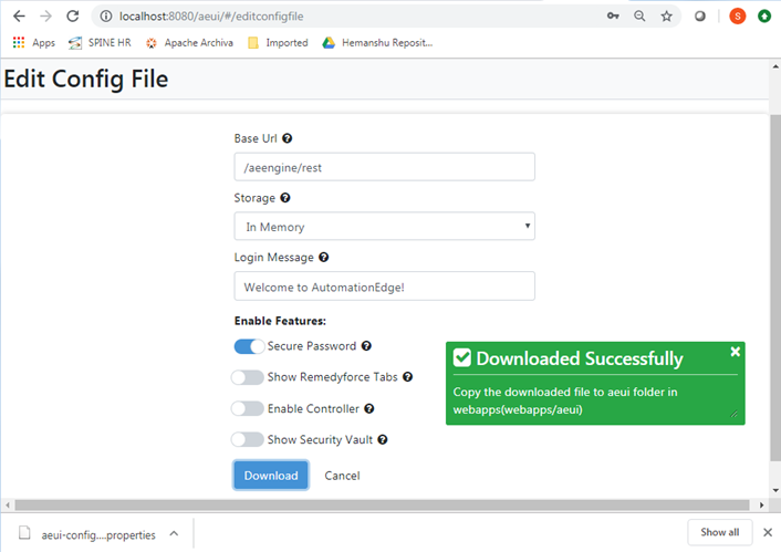

To store aeui-config.properties in encrypted format:
- Access the following URL, http://AE server host:8080/aeui/#/editconfigfile.
- Configure the required AEUI properties and download encrypted file.
- Replace the plain text file with the encrypted file.
