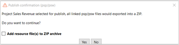

  1. Open Sales Revenue project, and then select File -> Publish -> Update. The Publish confirmation (psp/psw) dialog appears.
    If you have not saved the password for the current session, then AutomationEdge Connection Details dialog appears. Provide the password.
    CGS
    In the example, we do not have any supporting .csv, .txt, .xlsx, or other files. Therefore, do not select the checkbox, and click Yes.
    If you want to export the supporting files along with the workflow or process, then select the Add resource file(s) to ZIP archive checkbox. A corresponding dialog appears.

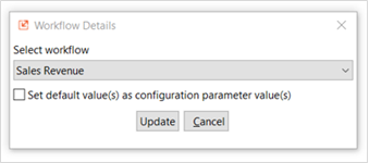

  2. In the Workflow Details dialog, select the workflow, Sales Revenue, and then click Update. A message confirming the workflow updated successfully appears.
    • If you are unable to see the workflow in the list, click More…, and then select the workflow. Use the filter to narrow the search list.
    • Parameters such as Assisted, Sequential, RDP enabled are inherited from the published workflow.
    • Select the Set default value(s) as configuration parameter value(s) checkbox, if required.
