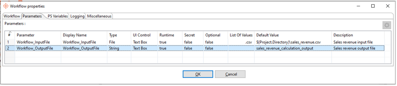

  1. Open the SalesRevenueCalculation workflow properties dialog and click Parameters tab. Add two parameters Workflow_InputFile and Workflow_OutputFile for input file and output filename, respectively. Specify Type for:
    • Workflow_InputFile parameter as File. For parameter type File, specify the extension allowed in List of Values, for example, .csv.
    • Workflow_OutputFile parameter as String.
    Keep Runtime option for both, Workflow_InputFile and Workflow_OutputFile. The Runtime option allows the user to provide the values at runtime during execution.
    CGS
    Provide a default value for the Workflow_InputFile parameter: ${Project.Directory}/sales_revenue.csv, where ${Project.Directory} is an internal Process Studio variable, which indicates directory where the file you are working on is saved. Provide a default value for Workflow_OutputFile. For example, sales_revenue_calculation_output.

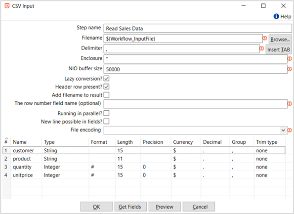

  2. Change Read Sales Data step to use the Workflow_InputFile parameter. Edit the Filename property of the step. On a Windows machine, press Ctrl + Space keyboard characters with focus on Filename and you will see list of available parameters and variables. Select Workflow_InputFile or type in ${Workflow_InputFile}.

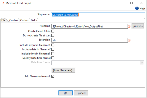

  3. Change the Microsoft Excel Output step to use the Workflow_OutputFile parameter. In the Extension field, see xls extension. Provide ${Project.Directory}, as the file path for the filename.

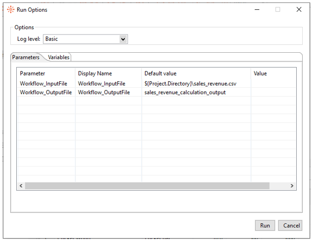

  4. Now run the workflow to open Run Options dialog. The dialog lets you specify value of input parameters before running the workflow. As we had provided correct default values for these parameters, we don’t have to provide a value for these again. But you can provide a value for any parameter to override the default value. Click Run to execute the workflow. Workflow gets executed as expected.
