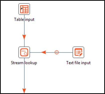

Stream Lookup enriches the primary data stream by looking up and adding fields from a second source step based on common key fields. The lookup data is cached in memory for fast access, making this step ideal for joining a main data stream with a smaller reference dataset — for example, adding product names from a text file to transaction records from a database, or appending category labels to raw data rows. Unlike Database Lookup, this step works entirely within the workflow stream without requiring a database connection for the lookup source.
