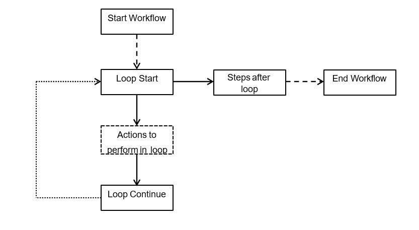

Schematic representation of a Workflow with Loops
Schematic representation of a workflow with loop steps

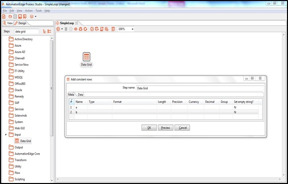

  1. Create a new workflow and save it as SimpleLoop
New SimpleLoop workflow in Process Studio

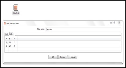

  1. Add a Data Grid step with meta data as shown below.
  2. Add data in the data tab.
Data Grid step metadata configuration Data Grid step data tab with sample records

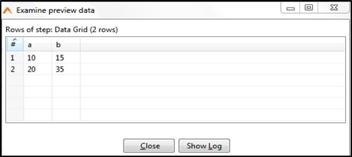

  1. Click Preview button to view the records.

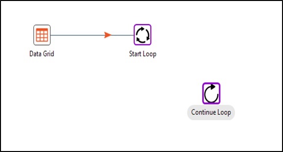

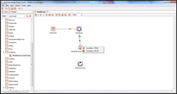

  2. Always Drag and Drop Start Loop Step or double click Start Loop. When you do this automatically a Continue Loop step is also created for you in Process Studio. These steps always exist in combination.
Start Loop and Continue Loop steps added to workflow

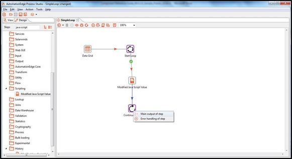

  1. Add a Modified Java Script step between Start Loop and Continue Loop. Whenever you create a Hop from Start Loop it is terminated with ‘Condition: TRUE’ or ‘Condition: False’. No Hops are allowed from Continue Loop.
  1. Join Modified Java Script to Continue Loop as shown below.
Modified Java Script joined to Continue Loop step

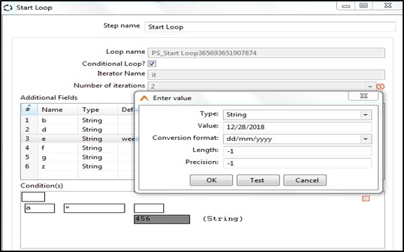

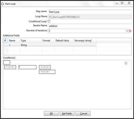

  1. Configure Start Loop. All the fields of Start Loop have been explained in the Configurations table.
    In this example we do not have a condition, instead we have created an iterator
Start Loop configuration with iterator and additional fields
‘addition’ with number of iterations for each row equals to 1.

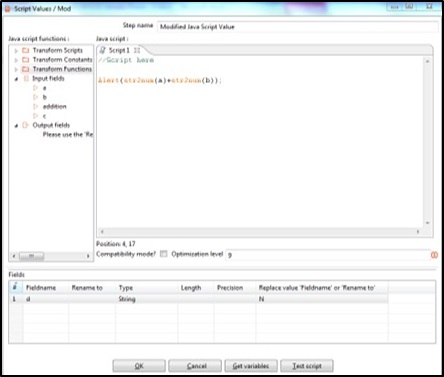

  1. Configure Modified Java Script as shown below to add two field values.
Modified Java Script configuration to add field values

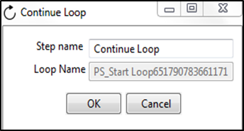

  1. Leave Continue Loop configurations as it is or alternately specify a Step name.
Continue Loop step configuration dialog

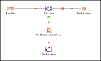

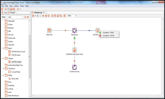

  1. Add a Text file output step. Draw a Hop with Condition: FALSE. This completes creating both Condition: TRUE and Condition: FALSE Hops.
Text file output step with FALSE condition hop Complete simple loop workflow in Process Studio
  1. This is the complete workflow. You can now run the workflow.

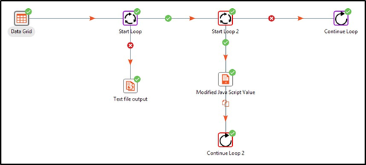

Sample Workflows: Nested Loop
Nested Loop can be considered as a loop in a loop. The following picture depicts a Nested Loop. In the screen shot the parent loop steps are ‘Start Loop’ and ‘Continue Loop’ as seen below. The child workflow steps are ‘Start Loop2’ and ‘Continue Loop2’.
Nested Loop workflow with parent and child loop steps
