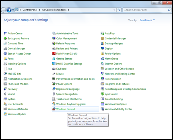

  1. Under Control Panel click Windows Firewall
CP

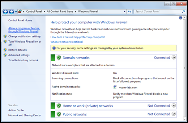

  1. Click the link – Allow a program or feature through Windows Firewall.
CP2
