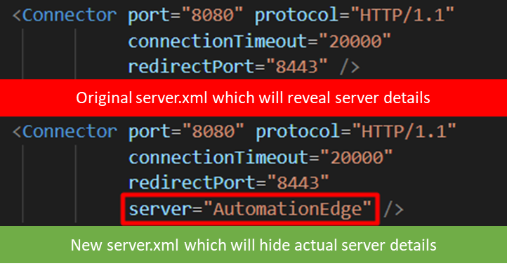

Hide server name and version
Hide the Tomcat server name and version. Complete the process of hiding the details and then restart the Tomcat server.
To hide Tomcat server name and version:
  1. Go to **\<Tomcat home\>/lib** and create the directory org/apache/catalina/util under lib.
  2. In the new directory, create a ServerInfo.properties file, and add an entry for server.info property in the file.
Keep the value for this property blank. For example, server.info=.
  1. Edit server.xml configuration file available under **\<Tomcathome\>/conf**, and add the following details in the Connector node:
The step is optional.
server="AutomationEdge"
JRE icon
Figure 2: Connector node view

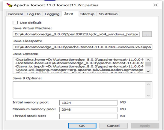

Tomcat: Memory Settings
You can set Tomcat memory settings in the following two ways:
  • Memory settings for Tomcat as service
  • Memory settings for Tomcat using command line
The memory setting for Tomcat is mandatory.

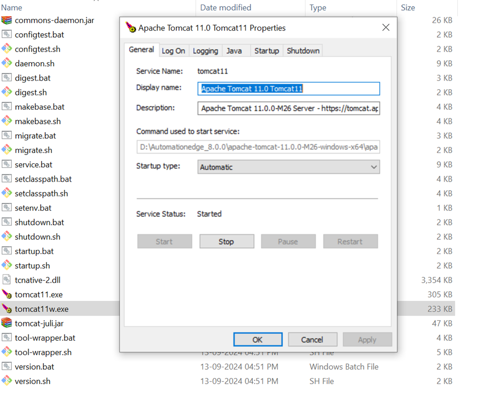

When running Tomcat as service, modify the memory settings, as required.
To configure Tomcat as service details:
  1. Stop Tomcat service, if it is up.
  2. Open the command prompt, go to %TOMCAT_HOME%/bin execute service.bat install. The Tomcat service is installed.
  3. Go to %TOMCAT_HOME%/bin, and select the Tomcat executable, and run it. For example, tomcat10w.exe. Running the executable will allow you to make changes to the Tomcat properties, if required.
  4. In the Java tab, make the following changes:
    Java Options section, enter:
-Djava.util.logging.config.file=\<yourPath\>\\conf\\logging.properties
\-Dspring.config.additional-location=\<yourPath\>\\AutomationEdge\\aehome\\conf\\ae.properties
\-DLOG_DIR=\<yourPath\>\\AutomationEdge\\tools\\apache-tomcat-10.1.30-windows-x64\\apache-tomcat-10.1.30\\logs
\-Dmanagement.health.tomcat.enabled=false
\-Dmanagement.health.file-descriptor.enabled=false
Change the following properties:
  • Initial memory pool: 1024 MB*
  • Maximum memory pool: 2048 MB*
You can increase the allocated memory to higher values depending upon the load on the AE server. For example, if a machine has 8 GB RAM set, the Initial memory pool: 2048 MB* and Maximum memory pool: 4096 MB*.
Apache Tomcat 11 Properties dialog
Figure 3: Apache Tomcat 11 Properties dialog
Remove all details from the Java 9 Options section.
  1. Start or restart the Tomcat Service.

Verify and start services
Change the Startup Type to Automatic for the following Windows services and start them in the following order:
  1. Database installed for AE, such as PostgreSQL
  2. ActiveMQ
  3. ApacheTomcat, the version installed for AE
