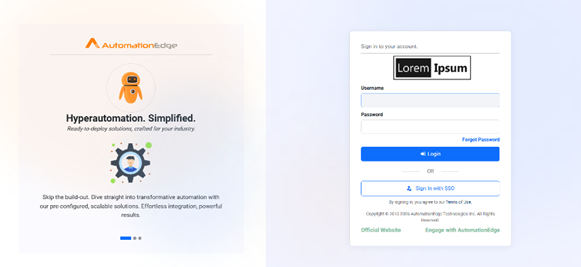

Co-branding Logo
Important: This feature is introduced in Release 8.2.4.
The co-branding logo will show your organization's logo (or a partner's) on the login page. It's a small visual change, but it's often what makes the platform feel like yours rather than a generic vendor tool.
- You can add an image to Tomcat/webapps/ROOT/brand to display your brand logo on the login page. The image must meet the validation requirements listed below:
- Content-Type : image/png, image/svg+xml, or image/webp
- File size ≤ 100 KB
- Magic bytes: Must match the PNG, SVG, or WebP signature
- Width (non-SVG only)≤ 400 px
- Height (non-SVG only)≤ 280 px
The co-branding logo can be configured in two ways, depending on your deployment setup:
Using Tomcat (Application-Level Hosting)
Place the logo file in the following location:
<TOMCAT_HOME>/webapps/ROOT/brand/customer-logo.<file_extension>
- Standalone Deployment Simply place the customer logo at the above location. No additional configuration is required.
- High Availability (HA) Deployment Ensure the logo file is present on all Tomcat nodes in the cluster. If NGINX is used and does not already proxy /brand/ requests to Tomcat, additional configuration is required. Sample NGINX Configuration (for proxying to Tomcat)

Using NGINX (Recommended – Static Hosting)
The logo can be served directly by NGINX as a static asset, avoiding routing through Tomcat.
- Place the logo file in an NGINX-accessible directory, for example: /usr/share/nginx/html/brand/customer-logo.png
- Configure NGINX to serve the /brand/ path from this directory. Sample NGINX Configuration:
location /brand/customer-logo.png { alias /usr/share/nginx/html/brand/customer-logo.png;
expires 1h;
add_header Cache-Control "public, no-transform";
# Allow only specific file types
if ($uri !~* \.(png|svg|webp)$) {
return 403;
try_files $uri =404;
- Ensure correct file permissions so NGINX/Tomcat can access the logo.
- After configuration changes, reload NGINX: nginx -s reload
