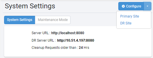

We assume there are two sites viz. Primary and DR. Complete the following configuration for Agents to switch seamlessly between Primary and DR sites:
  1. Navigate to Settings - System Settings. Click the dropdown and configure Primary Site and DR Site Server URLs.
    • The Primary site is on localhost:
    • The URL settings on DR site, 10.51.4.197, are automatically replicated from Primary site.
    alt text
