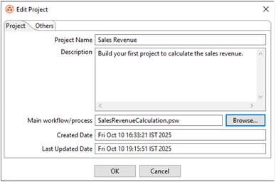

  1. Open Sales Revenue project, and then right-click and select Edit Project. In the Edit Project dialog, select the SalesRevenueCalculation workflow file to set as the main workflow.
    Notes:
    • Always select the workflow or process file as the main file before publishing. Else, you will see an error message.
    • If the project has multiple workflows or processes, then set the parent workflow or process as the main workflow or process.

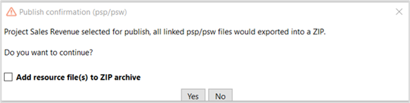

  2. Again, right-click on the project and select Publish -> Create. The Publish confirmation (psp/psw) dialog appears.
    If you have not saved the password for the current session, then AutomationEdge Connection Details dialog appears. Provide the password.
    CGS
    In the example, we do not have any supporting .csv, .txt, .xlsx, or other files. Therefore, do not select the checkbox, and click Yes.
    If you want to export the supporting files along with the workflow or process, then select the Add resource file(s) to ZIP archive checkbox. A corresponding dialog appears.

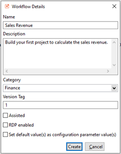

  3. A Workflow Details dialog appears with the following details:
    • Assisted: Enable Assisted for attended workflows.
    • RDP enabled: Enable RDP enabled if working on Controller Agent machine.
    • Set default value(s) as configuration parameter value(s): Enable the checkbox, if you wish to set default values as configuration parameter values.
    In case of most GUI workflows and workflows with particular steps the workflow is internally marked for sequential execution. Else, if one of the workflows running as non-sequential workflow is terminated, then all the subsequent requests remain in the New state.
    For the workflows, after publishing, the Enable Sequential Execution checkbox is automatically selected on the AutomationEdge UI workflow edit page.
  4. In the Workflow Details dialog, click Create. A message appears confirming that the workflow is created successfully.

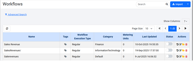

  5. Now, logon to AutomationEdge instance on which you created the workflow. In the Workflow List menu, you can see the newly published Sales Revenue workflow.

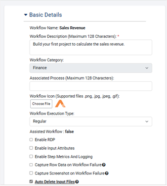

  6. After publishing the workflow to AutomationEdge server, you need to configure and then activate the workflow. In the Actions column, click Edit icon. The Configure Workflow Details page appears.
    CGS
    Details provided when publishing through Process Studio appear in the respective fields. Enter other details, such as Expected Completion Time, Maximum Completion Time, Cleanup Requests older than, and Manual Execution Time, as required.

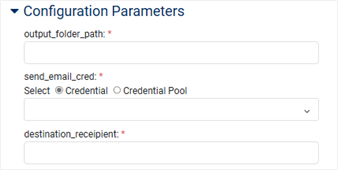

    ii. In the Configuration Parameters section, configure the details, if required.

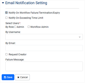

    iv. In the Email Notification Setting section, configure the details, and then click Save. Workflow updated successfully message appears.
