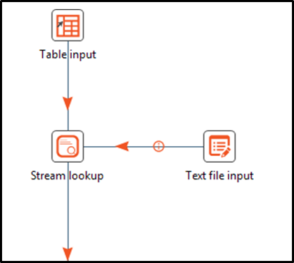

Stream Lookup is a step in the Lookup Plugin for Process Studio Workflows. The Stream lookup step looks up data and adds it to information coming from other source steps in the workflow. The data coming from the Source steps is cached into memory and then a common key field is used to look up data from the lookup table. In the example below, database table input is the primary input. The workflow looks up data in a text-file based on a common key field.
