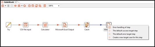

On Process Studio UI while joining output hops from Catch step the following options are shown,
- Error handling of step (AE Process Studio’s error hop to handle ‘Catch’ step related error)
The Catch step has an error handling hop, to handle any errors that might occur in the step. Following are the possibilities of errors.
- Invalid Target Step name in any of the fields.
- Neither anything is specified in the Error Handling table nor the Default Error Target Step.
- The error does not match the entries in the Error Handling table and Default Error Target step is not specified.
- The default success target step
- Create a new error target case for this step

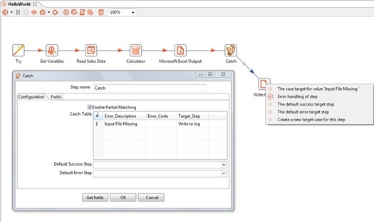

Also once an error case is added in Catch table in the Configuration tab in the step it is also shown in the options of output hop as “The case target for value
<Error Description> <and <Error Code>>”.In the following screenshot, there is an entry in the Catch table, hence you can see an additional outgoing hop “The case target for value ‘Input File Missing’”.

| 1 | Enable Partial Mapping | Enable checkbox to compare the errors partially with the error received, |
| 2 | Catch Table: | This table contains the details of how the errors have to be routed. The priority depends on the sequence. The fields in this table are not mandatory. |
| i | Error_Description | Specify a full or partial error description to handle. |
| ii | Error_Code | Specific plugin error code to handle. If the Error description and Error Code are specified in a single entry, both will be verified before forwarding to the target step. |
| iii | Target_Step | The target step to move to or traverse when the error occurs. |
| 3 | Default Success Step | If there aren't any errors in between Try - Catch, the row will be forwarded to the step specified here. This field is not mandatory. |
| 4 | Default Error Step | If the error occurred does not match any entries in the ‘Error Handling’ table, the row will be forwarded to the step specified here. This field is not mandatory. In case this field is empty, the workflow terminates at the 'Catch' step with the error which is received by the 'Catch' step. |

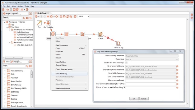

Open Step error handling settings for any step with Error handling option enabled in the popup navigation, between Try-Catch steps as seen below. The various Error Handling field names are pre-populated (and disabled) by Try-Catch as seen below.
These Error Handling field names are generated by Try-Catch. These field names can be changed by configuring with user defined names in the Fields tab.
