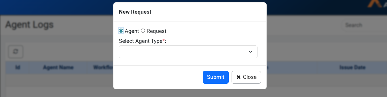

You can access Agent Logs from the AutomationEdge Agent Log menu. Debug logs are included as part of the Agent Logs. To view them, go to the Logs menu and select the Agent Logs sub-menu in AutomationEdge. You can also obtain Agent Logs by clicking the New Request button in the top-right corner. Select the source at the Agent or Workflow level, as shown in the screenshot below.
Agent Logs menu with New Request button for obtaining debug logs
