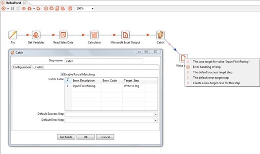

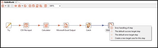

On Process Studio UI while joining output hops from Catch step the following options are shown,
- Error handling of step (AE Process Studio’s error hop to handle ‘Catch’ step related error)
The Catch step has an error handling hop, to handle any errors that might occur in the step. Following are the possibilities of errors.
- Invalid Target Step name in any of the fields.
- Neither anything is specified in the Error Handling table nor the Default Error Target Step.
- The error does not match the entries in the Error Handling table and Default Error Target step is not specified.
- The default success target step
- Create a new error target case for this step
Also once an error case is added in Catch table in the Configuration tab in the step it is also shown in the options of output hop as “The case target for value
<Error Description> <and <Error Code>>”.In the following screenshot, there is an entry in the Catch table, hence you can see an additional outgoing hop “The case target for value ‘Input File Missing’”.

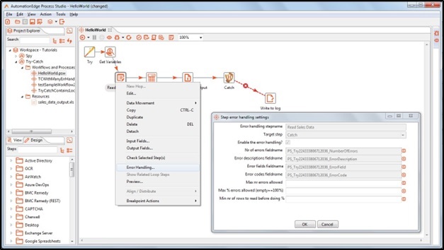

Open Step error handling settings for any step with Error handling option enabled in the popup navigation, between Try-Catch steps as seen below. The various Error Handling field names are pre-populated (and disabled) by Try-Catch as seen below.
These Error Handling field names are generated by Try-Catch. These field names can be changed by configuring with user defined names in the Fields tab.
