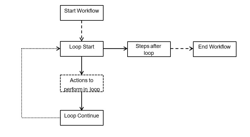

Schematic representation of a Workflow with Loops

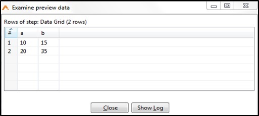

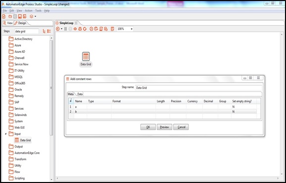

Add a Data Grid step with meta data as shown below.

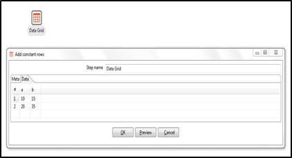

Add data in the data tab.
- Click Preview button to view the records.

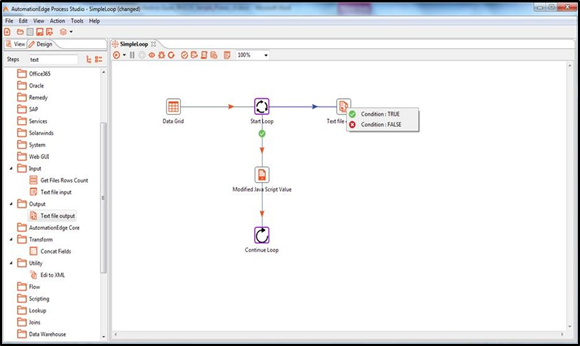

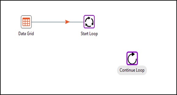

- Always Drag and Drop Start Loop Step or double click Start Loop. When you do this automatically a Continue Loop step is also created for you in Process Studio. These steps always exist in combination.

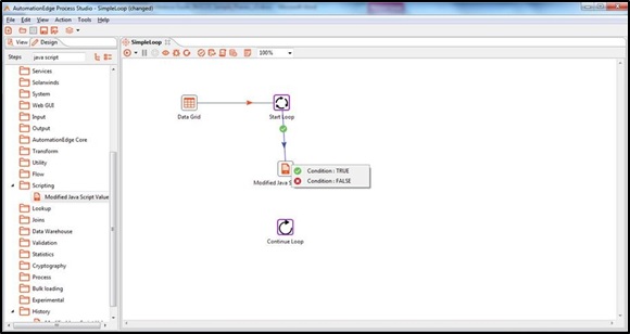

- Add a Modified Java Script step between Start Loop and Continue Loop. Whenever you create a Hop from Start Loop it is terminated with ‘Condition: TRUE’ or ‘Condition: False’. No Hops are allowed from Continue Loop.

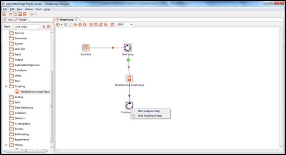

- Join Modified Java Script to Continue Loop as shown below.

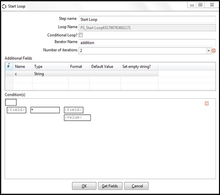

- Configure Start Loop. All the fields of Start Loop have been explained in the Configurations table.
In this example we do not have a condition, instead we have created an iterator
‘addition’ with number of iterations for each row equals to 1.

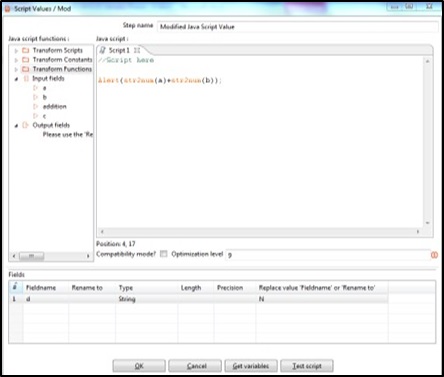

- Configure Modified Java Script as shown below to add two field values.

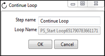

- Leave Continue Loop configurations as it is or alternately specify a Step name.

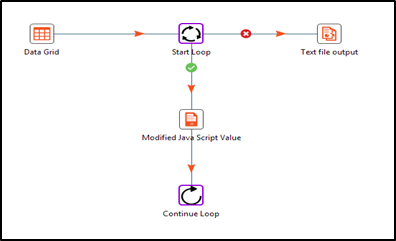

- Add a Text file output step. Draw a Hop with Condition: FALSE. This completes creating both Condition: TRUE and Condition: FALSE Hops.
- This is the complete workflow. You can now run the workflow.

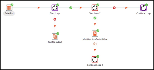

Nested Loop can be considered as a loop in a loop. The following picture depicts a Nested Loop. In the screen shot the parent loop steps are ‘Start Loop’ and ‘Continue Loop’ as seen below. The child workflow steps are ‘Start Loop2’ and ‘Continue Loop2’.
