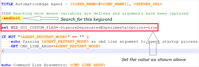

    For AE-Agent, update the flag in startup.bat as follows:
Step 1:
  • Search for: endInit
  • set WEB_GUI_CUSTOM_FLAG=-DignoreDeprecatedExperimentalOptions=true
step1

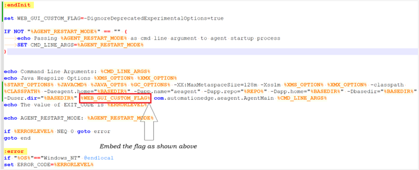

Step 2:
  • In the file, search and embed the flag as follows:
step1

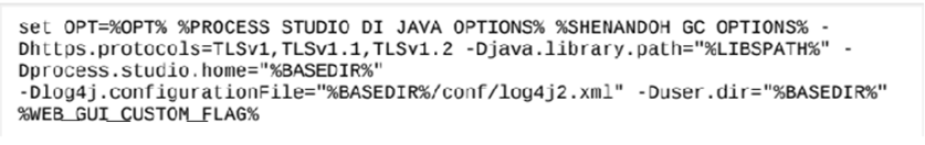

Similarly, in the process-studio.bat file, set the WEB_GUI_CUSTOM_FLAG as shown in the following screenshot, if required:
step1
Update the following in the file:
step1

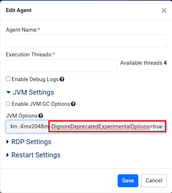

As an Admin, you can also set the flag, -DignoreDeprecatedExperimentalOptions=true directly through the Agent Settings option in the AE UI. For details, see Edit Agent Field Details section in the AutomationEdge User's Guide.
step1

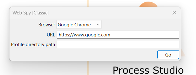

Web Spy [Classic]
Web Spy [Classic] is used to build workflows with Web-GUI [Classic] plugin steps for web applications.
