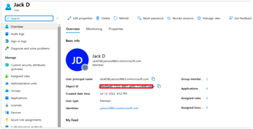

- To get the user ID, see the following screenshot:
