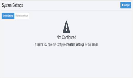

  1. In the menu, go to Settings→System Settings. The System Settings page appears with the System Settings tab selected,by default.
    If you are configuring the details for the first time, then the System Settings page appears blank.
    System Setting
    Figure 114: System Setting page
  1. On the page, click Configure. The configuration fields appear.

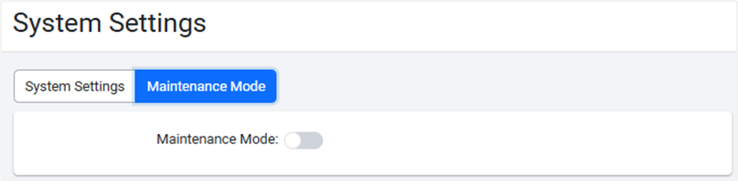

    To enable maintenance mode:
  1. In the menu, go to Settings→System Settings. The System Settings page appears with the System Settings tab selected, by default.
    Maintenance Mode view
    Figure 116: Maintenance Mode view
  2. On the page, click the Maintenance Mode tab, and then toggle the Enable Maintenance Mode switch. A message asking for confirmation to enable the mode appears.
  3. On the message dialog, click Enable. The maintenance mode is enabled(IMG_256)

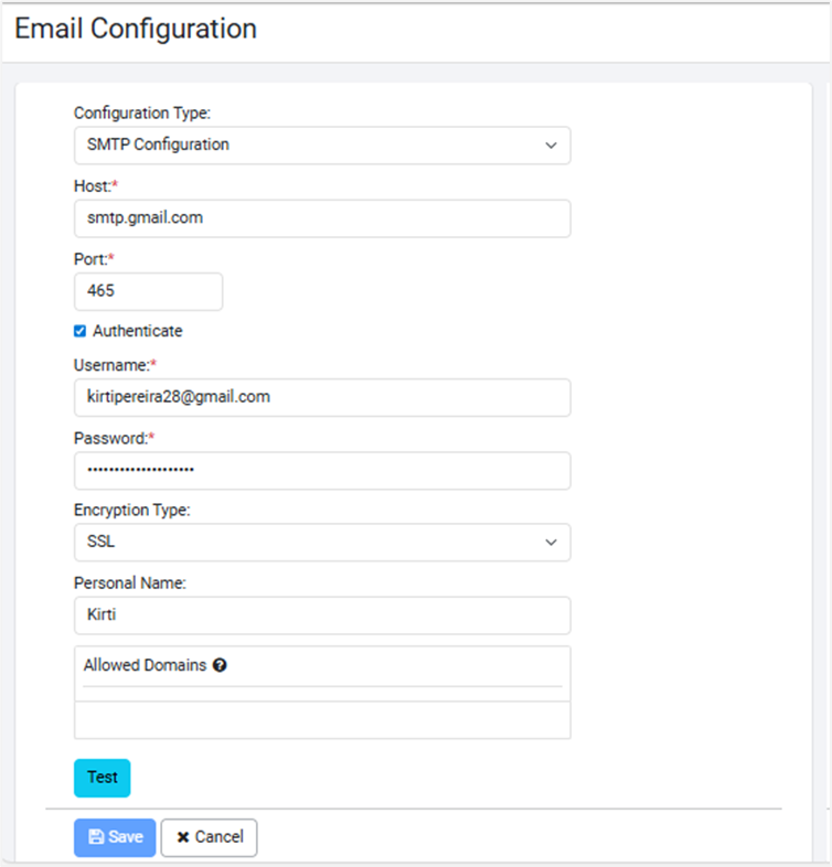

SMTP Configuration
You can configure the email server using the Simple Mail Transfer Protocol (SMTP) configuration.

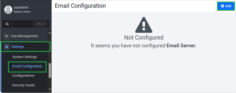

To add an SMTP email configuration
  1. In the menu, go to Settings→Email Configuration. The Email Configuration page appears.
    If you are configuring the details for the first time, then the Email Configuration page appears blank. Email Configuration page
    Figure 117: Email Configuration page
  2. On the page, click Add. The Email Configuration fields appears.
    Email Configuration Page
    Figure 118: Email Configuration page
  3. Click in the Configuration Type list and select SMTP Configuration. The SMTP Configuration detail fields appear.
    SMTP Email Configuration page
    Figure 119: SMTP Email Configuration page
  4. Enter the following field details:
    Field Description
    Configuration TypeSelect the type of configuration for which you want to configure the email settings. For example, SMTP Configuration.
    Host* Enter the hostname or IP address of the LDAP server.
    Port*Enter the port number for LDAP connectivity. For example for Gmail SMTP server the port is SSL 465 TLS 582.
    Authenticate Select the checkbox if you want to authenticate the user before connecting to the SMTP server.
    Note: If you select the checkbox, then the Password field is available.
    Username*Enter a username for authentication. For example, Email ID is the username for Gmail.
    Password* Enter the app password for user authentication. For example for Gmail the password is the 16 digit app password
    Note: The app password is not your mail login password.
    Encryption type Select the type of encryption you want. Available options are:
    - SSL
    - TLS
    Note: The Protocols field appears only if you select TLS..
    Protocols Select one or more protocols for setting up SMTP configuration. IMG_256
    Figure 120: Encryption Type dialog
    Personal name Enter the personal name as it will appear in the email.
    Allowed DomainsEnter the names of domains to which you want to send the emails. You can add multiple domains by separating them with commas or by pressing Enter after each domain.
    For example, if you have added gmail.com to the domain list then you can send emails only to Gmail domain users.
    Note: If you have not created the allowed domain list, then you can send emails to users of any domain. And, if you create the allowed domain list, then you can send emails to users of the listed domains only. You will see an error message, if you try to send email to users outside the listed domains. Allowed domains is applicable throughout AutomationEdge UI.
    * Indicates mandatory field.
  5. Click Test to validate the SMTP connectivity. A message confirming the success of the connectivity appears.
  6. Click Save. The SMTP configuration details are saved.

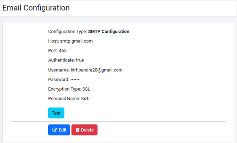

    Email Configuration
    Figure 120: Email Configuration
• To modify the email configuration details, click Edit.
• To remove the email configuration details, click Delete.

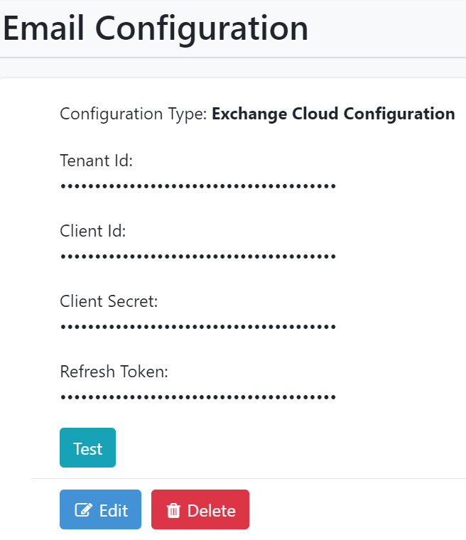

Exchange Cloud configuration
To use Exchange Cloud configuration, you must have a Microsoft account. Create an account through the Azure AD portal.
For details, see Appendix 17: Office 365 App Registration for Grant Type Refresh Token in Plugin Reference Guide
To add an Exchange Cloud configuration:
  2. On the page, click Add. The Configuration Type selection dialog appears.
  3. From the list, select Exchange Cloud Configuration. The Exchange Cloud Configuration detail fields appear.
    ExchangCloudConf
Figure 121: Exchange Cloud Configuration page
  1. Enter the field details:
    Access your Microsoft account to fetch the details and copy-paste them in configuration page.
    Figure 122: Exchange Cloud Configuration details
    The details will appear encrypted in the fields
    Field Description
    Configuration TypeSelect the type of configuration for which you want to configure the email settings. For example, Exchange Cloud Configuration.
    Tenant Id* Copy-and-paste your Microsoft account Tenant Id.
    Client Id* Copy-and-paste the client ID of the application created in your Microsoft account.
    Client Secret* Copy-and-paste the client secret generated in your Microsoft account.
    Refresh Token* Copy-and-paste the refresh token generated in your Microsoft account.
    For example, if you have added gmail.com in the domain list then you can send emails only to the Gmail domain users.
    Allowed domains are applicable throughout AutomationEdge UI.
  2. Click Test to validate the Exchange Cloud connectivity. A message confirming the success of the connectivity appears.
  3. Click Save. The Exchange Cloud configuration details are saved.

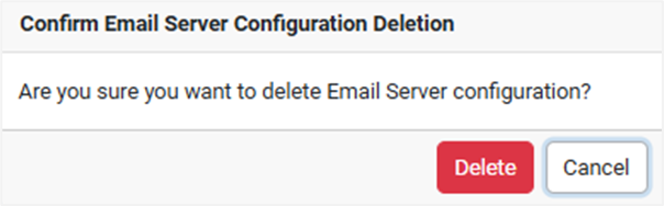

To delete an email configuration:
  1. In the menu go to Settings->Email Configuration. The Email Configuration page appears.
  2. On the Email Configuration page, click Delete. The confirmation dialog appears. For example, if you are deleting SMTP Configuration, then the Confirm SMTP Configuration Deletion dialog appears.
    alt text
    Figure 123: Confirm SMTP deletion dialog
  3. On the dialog, click Delete. The SMTP configuration deleted successfully message appears.

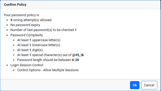

  2. Click Login Policy and toggle the switch to set the number of login attempts for the user. You can set the value between zero to ten (0 to 10).
• The default value is 0, which indicates that there is no limit on the number of times a user will be able to sign in even after an incorrect sign in attempt.
If you set a value other than 0, the user is informed about the number of attempts left after every incorrect sign in attempt.
If the number of attempts exceed the set value, then the user account is locked. For more information on unlocking a user account, see Unlock user account.
• You can also configure the maximum limit for the Login Policy, as per your organization security requirements. In the ae.properties file, configure login-policy.upper-limit.number-of-attempts. login-policy.upper-limit.number-of-attempts:10
  1. Click Password Policy, and toggle the switches for the respective fields:
Field Description
Password PolicyNOTE: You can also configure the maximum limits for the Password Policy, as per your organization’s security requirements. In the ae.properties file.
• password-policy.upper-limit.password-validity-months:12
• password-policy.upper-limit.password-history:30
• password-policy.upper-limit.max-length-password:30
• password-policy.upper-limit.min-length-password:20
Password Expiry (In months)Scroll to set the password expiry month. You can set the month between 0 to 12.
NOTE: If you set the value as 0, then there is no expiry month for the password.
Password History  Scroll to set the number of previous passwords that cannot be reused by the user. The default value is one.
NOTE: One is the minimum value and maximum value is 20.
Minimum Length Scroll to set the minimum length of the password. The default minimum length of a password is six characters.
Maximum Length Scroll to set maximum length of the password. The default length is 30 characters.
NOTE: If you want you can modify the password-policy.upper-limit.max-length-password value in the ae.properties file, ensure that you also update the maxLengthOfPassword value in the aeui-config.properties file.
For example:
In ae.properties, add:
password-policy.upper-limit.max-length-password = 20
In aeui-config.properties, add:
maxLengthOfPassword = 20
Minimum UppercaseScroll to set the minimum uppercase characters you want in the password. The default and minimum value is one and maximum value is 17.
Minimum LowercaseScroll to set the minimum lowercase characters you want in the password. The default and minimum value is one and maximum value is 17.
Minimum Special CharactersScroll to set the minimum special characters you want in the password. The default and minimum value is one and maximum value is 17.
For example, special characters, such as @, #, and so on.
Minimum Digits  Scroll to set the minimum digits you want in the password. The default and minimum value is one and maximum value is 17.

  1. Click Save. The details are saved, and the Confirm Policy dialog appears.
alt text
Figure 125: Confirm Policy Dialog
  1. Click Ok. The password policy updated successfully.

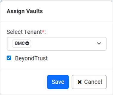

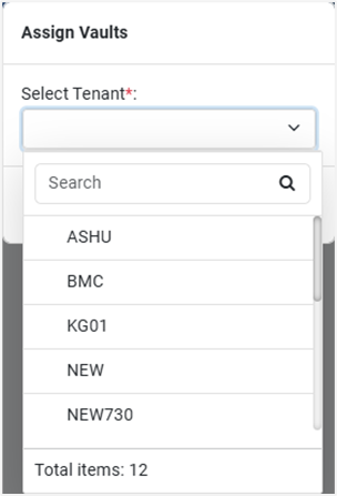

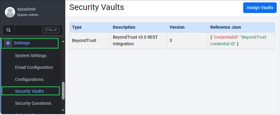

To assign security vaults to tenants: 
  1. In the menu, go to Settings->Security Vaults. The Security Vaults page appears.
    SecurityVaults
    Figure 126: Security Vaults page
  2. On the page, click Assign Vaults. The Assign Vaults dialog appears.
    Figure 127: Assign Vaults dialog: Tenants
  3. Select the tenants to which you want to assign the vaults, and then select the vault type.   Assign Vaults dialog: Type
    Figure 128 : Assign Vaults dialog: Type
  4. Click Save. The vault is assigned to the selected tenant.

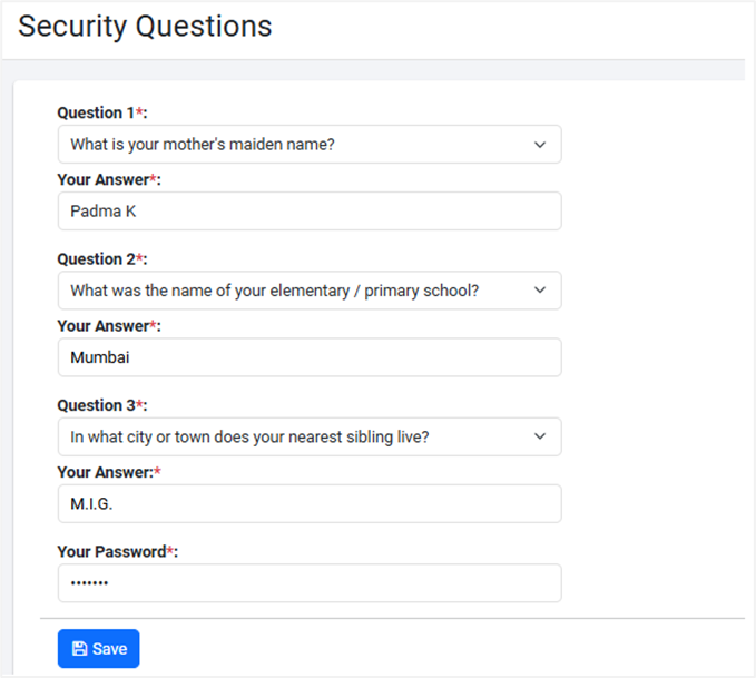

Set Security Questions
Setting security questions is essential in enhancing the security of user accounts and supporting account recovery.
To set security questions:
  1. In the menu click, Settings -> Security Questions. The Set Security Questions page appears.
  2. Select the queries that you want to set as security questions, enter the answers, and then click Save. A message confirming that the security questions are set successfully appears.
Security Questions dialog
Figure 129: Security Questions dialog
If you click Skip, you are directly taken to the Tenants page.

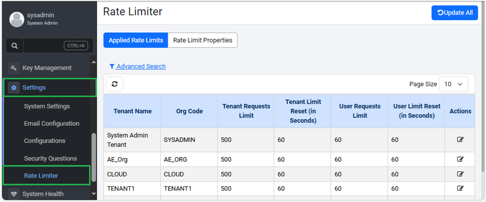

To view or modify the applied rate limits
  1. In the menu, go to Settings -> Rate Limiter. The Rate Limiter page appears.
  2. The Rate Limiter page has two tabs, Applied Rate Limits and Rate Limit Properties tabs. The Applied Rate Limits tab is selected, by default.
    Rate Limiter page
    Figure 130: Rate Limiter page
The default applied limits are same for all tenants and tenant users.

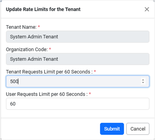

  1.  To modify the request limit details at individual level, click IMG_256. The Update Rate Limits for the Tenant dialog appears.
    Figure 131: Update Rate Limits for the Tenant dialog
  2. Modify the tenant or user request limit, and click Submit. The updated details appear in the table on the Rate Limiter page.

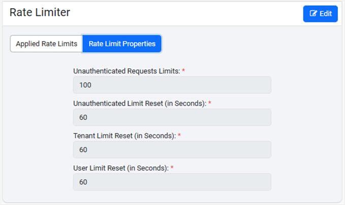

In addition, you can modify the rate limit for unauthenticated requests and the time limit after which the users can again attempt to make request calls.
To modify the rate limit properties
  2. Click the Rate Limit Properties tab. The properties details appear.  Rate Limit Properties dialog
    Figure 135: Rate Limit Properties dialog
  3. Click Edit. The read-only fields become available for modifying the details.
  4. Modify the details, as required, and click Save. The limit details are updated.
