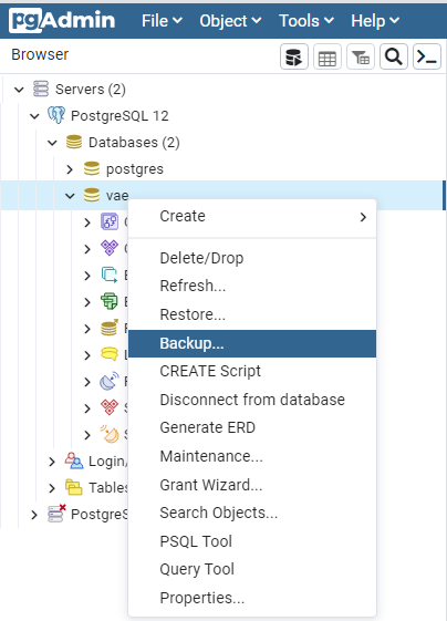

  • Take the backup of your database. For example, if your database is PostgreSQL, then:
    Sign in to the database with your username and password, and then go to the database → right-click and select Backup.
    Save the database backup in a location of your choice.
    Database backup dialog

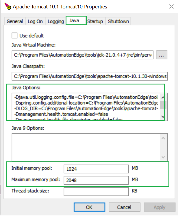

    If Tomcat services have not been configured for JRE 21 perform the following:
    Tomcat Services need to be either recreated or reconfigured after migration to JRE 21 version.
    Following are the steps to reconfigure Tomcat:
    • Stop Tomcat if not already stopped.
    • Locate and open execute Tomcat Monitor Application <TomcatServiceName>w.exe available at \<Tomcat Home\bin>. For example, tomcar10w.exe or AE-Tomcat-10.1.30w.exe in case AE is installed using the AE installer in E:\tools\apache-tomcat-10.1.30\bin\.
    • It opens the Tomcat Monitor Application.
    • Following dialog appears, change the Java Virtual Machine Path to point to the JRE 21 jvm.dll available in <JRE_HOME>/bin/server.
    Tomcat Monitor JRE configuration dialog

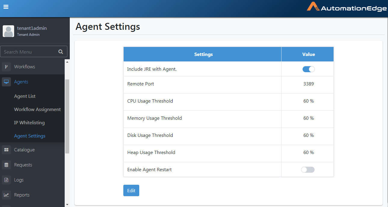

  • Following are the actions so that Agents are bundled with JRE 21 from AutomationEdge server:
    i. In the AE UI, navigate to Agents 🡪 Agent Settings page. On the page toggle the Include JRE with Agent switch to enable the bundling of JRE with the Agent.
    Agent Settings Include JRE toggle
    When the system migrates to 8.5.0, Agents will automatically upgrade and migrate to JRE21 supplied by AE.
