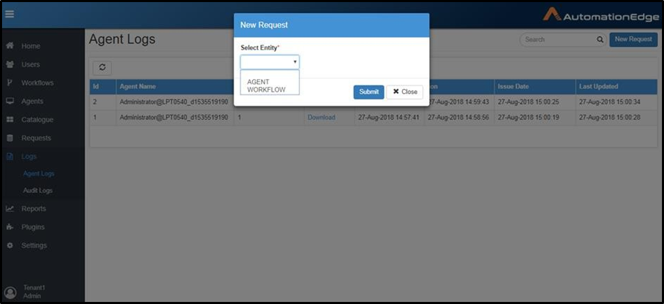

Notes: Secret variables are logged as ‘XXXX’
Agent logs are also accessible from AutomationEdge Agent Log menu. Debug logs are part of Agent Logs. Agent Logs are visible by navigating to the Logs menu and Agent Logs sub -menu in AutomationEdge. Agent logs can be obtained by clicking the New Request Button on the top
